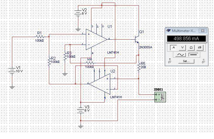

guys, i need some help...
i'm looking for a voltage-controlled current source...
i found this: http://electronicdesign.com/Articles/ArticleID/9018/9018.html"
but when i try it for a maximum current of 500mA (using LM324N for the opamp and 2N2222 for the transistor), it doesn't work...
help me pls...
does the current source sink to ground? or are both terminals floating?
you mean the output terminals?
i was thinking of inserting an ammeter on the output side to get the maximum current reading..
+Vout > Ammeter > -Vout > Zener > -Vcc > Ground
or you're talking of something else? sorry...

Several issues... First, if you want 500mA, you will need a lot bigger transistor than the 2N2222. That transistor is more like a 100mA transistor (if that). Second, you mention a LM324, but the app note shows an LM321 precision opamp. The LM321 is meant for split supply operation, and can handle the +/- 16V supplies in the diagram. The LM324 is optimized for single supply operation, and can only handle +/-15V max. If you gave it +/-16V, it is toast.
Also, the output reference voltage of that figure is a bit strange. Can you just have your current source work with respect to ground? What output voltage range does the current source need to be able to work with (that's called its "compliance")?

attached is the modification i made to the circuit, on the ammeter it reads 490+ mA... but when i try to do it on the breadboard, i get 0 A... pls advice :(

Try this,
Hook up a precision resistor to monitor the current being consumed(drop).
Use a precision opamp as differential amplier for feedback/stabilisation.
You can use a transistor to sink the current at the output.
Or else you can go with a combination of LM723 and 2N3055. you should be able to tune the circuit for 500mA.

I tried some more modifications. Now, though a little less than theoretical, it outputs something...
For better accuracy, I'll try what you suggested...
