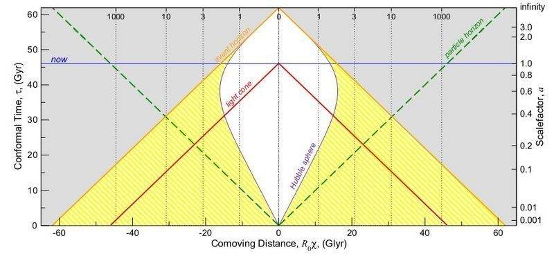

Here is a much clearer graphic of the the bottom band of Lineweaver's figure 1 that Marcus referred to.
It is from the Tamara Davis 2003 doctoral thesis, page 8. I think she was the originator of the diagrams referred to. The figure also sports a very thorough caption, explaining all the diagrams.
For those not familiar with conformal time, it is a transformation that divides a proper time interval 'dt' by the the scale factor, i.e. [itex]d\tau = dt/a[/itex]. The interesting thing about conformal time is that it makes the expanding spacetime appear 'flat' and it covers proper time from zero to infinity (because 'a' can go to infinity on the right-hand scale).
The three distance scales that Marcus referred to (CMB at 45.3 Gly, present particle horizon at 46.7 Gly and maximal particle horizon at 62.3 Gly) are all easy to spot on the diagram. Where the dotted gray line marked 1000 intersects the red light cone, move a little to the right (1100); there resides the CMB. The present particle horizon is where the red line reaches time zero. Beyond that we cannot presently observe anything by any means. The maximal particle horizon is where the yellow/gold area reaches time zero, beyond which nothing will ever be observable (unless there was something to be somehow observed before time zero. ;) There are probably 'things' in the gray zone, possibly extending to infinite distance, but we can never have any contact with them.
As time moves to the future, the light cone will shift upwards, but never quite reach the top, which is proper time infinity. Because of the 45 degree slopes, the diagram is actually cast in stone - all that would change if we should find that a need to revise our cosmological parameters, is the scale on the axes - that is unless we find that we have to also modify the LCDM model radically?
