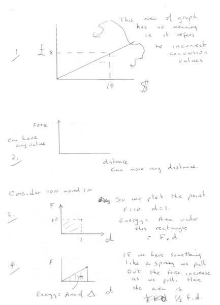

Since I am replying I had prepared further information for sahil in the attachment.
You asked about the introduction of an integral of force over distance.
Yes indeed energy can be counted as an area.
We say that work is done when a force moves is point of application.
The movement is usually called displacement rather than distance so I have labelled one axis that way on my graphs.
Now the graphs are not the same as say, the graph showing the conversion of $ to £. The area under such a graph has no meaning. All the meaning is in the line so we can read off say
£8 = 10$.
I have shown this in fig 1 in the attachments. The only valid values lie on the line £ = contstant x $
However we can allow our force to have any value and move any distance so any point in the xy plane is acceptable. this is shown in my fig2
Taking some particular values say F = 10 and d = 1 we can plot this as a point.
The movement must have started out at zero displacement and moved through all possible values of displacement < 1 until a displacement of 1 was reached.
If F is a constant force such as gravity, the action will have taken place along the dashed line in Fig3 parallel to the x-axis at F=10.
The energy is equal to the work done = force times distance which is equal to the area of the rectangle under bounded by the two dashed lines.
If you like it is made up of all the little contributions from d = 0.1; d = 0.2 etc. That is what is meant by force over distance rather than just force times distance. The integral can also be used to calculate sums (if you have not yet covered this you will) and this is an example.
The energy figure or shape is not always a rectangle.
In fig 4 I have shown what happens if we extend a spring.
At the outset the restoring force is zero so no energy is used to extend it.
At some value of extension d there is a restoring force F which has built up from zero to F.
So we take the average or
[tex]\frac{{\left( {0 + F} \right)}}{2}[/tex]
for the force and our area is a triangle as shown.
In fig 5 I have put some other numbers to the constant force graph for comparison
In figs 6, 7 and 8 I have shown different ways to obtain the same energy as
E = force x displacement
E = half the force x twice the displacement
E = twice the force x half the displacement

Over has a much wider meaning, even in mathematics, than just division. I think the use for division arose because of the use of fractions to show division so five over eight means five divided by eight.
But eight is only a single number or point.
How would you divide by an area?
One apple tree divided by eight acres does not make sense.
The meaning of 'over' in this case is exemplified by the sentence:
We scattered the seed over eight acres.
Clearly there is an intention to show that the seed (or some part of it) could fall on any part of the eight acres. Eight acres has many points.
Going back to the 'force over distance' phrase, the point of application of the force moves through (or over) all points in the distance concerned. If the final distance is 10 metres, at some point in time the distance is first 1 metre, 2 metres, 3 metres and so on. At any of these points we could stop and reckon up the work performed.
If the force is constant throughout then this reckoning is simply the force times the final distance.
If the force is not constant (ie varies along the way) then the reckoning is more difficult. This is where we have to add up all the little bits of different values of F times the distance.
Luckily we find that this reckoning (sum) is exactly equal to the area under the force v distance graph. So this is where the integral steps in.
It really all does tie together.
