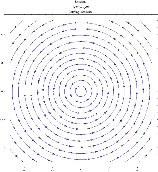

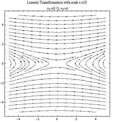

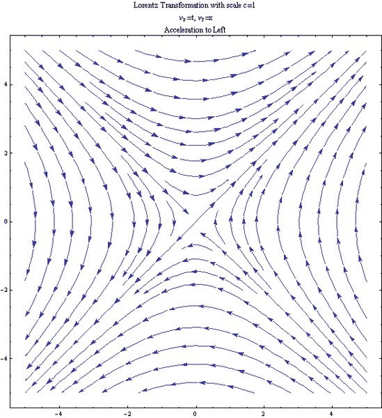

It has something to do with the difference between the trigonometric functions and the hyperbolic trig functions.
Solutions of dy/dx=-x/y lead to x^2 + y^2 = Constant. These are circles.
Solutions of dx/dt = t/x lead to t^2 - x^2 = Constant. These are hyperbolas.
One big difference is that if you have something in front of you, you can turn around and make it to your left, then behind you, then to your right, then in front of you again. It all forms one continuos circle.
On the other hand, you can't take an event that's in your future, and and turn until it is to your left, then in your past, then to your right, then in your future again. They are four separate hyperbolas.

Another way of looking at it is that when you are talking (x,y) coordinate distance, you can imagine concentric circles around either particle and ask, what concentric circle the other particle is on. The answer involves a r=\sqrt{x^2 + y^2}
With (x,t) event distances, you can imagine "concentric" hyperbolas around one of the events and ask which hyperbola the other event is on. The answer involves a \tau = \sqrt{t^2-x^2} or s=\sqrt{x^2-t^2} (depending on which quadrant you're in.)

rather than
d \tau^2 = dt^2 - \frac{1}{c} dx^2 - \frac{1}{c} dy^2 - \frac{1}{c} dz^2
The fact that c is such a large number (300 million meters per second) means that the two equations look identical in our experience, so it seems like there is only one direction in time.
For visualization purposes, imagine what this diagram would look like if c were set to 300 million meters per second (by setting the vertical scale to seconds, and the horizontal scale to meters), instead of c=10
The hyperbolas on the top and bottom would flatten into horizontal lines, and the ones on either side would disappear altogether. The lines would mark off t≈τ=-1, t≈τ=0, t≈τ=1, t≈τ=2, etc.
Eight observer dependent directions:
I may be belaboring the point, but, with this in mind, it should be understood that there are basically eight observer-dependent directons. Up (z), down, left, right (x), forward(y), and backward are what we are familiar with, and these are all obviously observer dependent, because if we are facing different directions, you know that my Δx' and Δy' are different from your Δx and Δy.
What's not at all obvious in our daily experience is that future and past are also observer dependent directions. If you and I are traveling at different velocities in the x direction then my Δx' and Δt' are different from your Δx and Δt. Our intuition that comes from years of living in a world where speeds of even .01c are inconceivably high, is that there is only one direction in time, and that this direction is NOT observer dependent.
