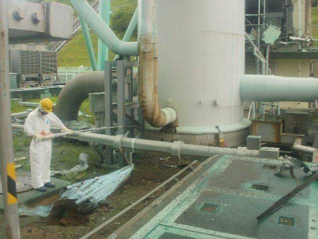

Talking about "cutely-colored site contamination maps", this seems to be the most recent one available still:
http://www.tepco.co.jp/en/nu/fukushima-np/f1/images/f1-sv-20110802-e.pdf
Tepco published it on Aug 2, 2011.

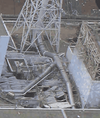

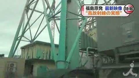

At the joint U1/2 stack near unit 1 the yellow label says "70~100" (mSv/h). On a large bubble off to the left it says "U1/2 SGTS >10,000".
I think the pictures were taken towards the west, as you see the slope behind. Also, there's a small damaged two storey structure behind the stack. This is visible inside the stack frame on the west on aerial shots from the south on Cryptome.
The vertical brown-stained pipe is probably connected to one of the two smaller pipes that run along the fat pipe from the Y-section leading to units 1 and 2. There's one at each side of the fat pipe.
Ian Goddard speculates on his site that the brownish colour is not rust but cesium. However, for that the pipe would have to be leaky, for you to see cesium condensate on the outside, not just the inside.

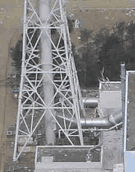

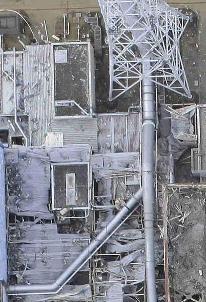

  • #10,801
The brown-stained section of the pipe is the last final bit of pipe before entry into the stack, this last bit is shared by the exhausts from unit 1 and 2 EGTS (Emergency Gas Treatment Systems).
Right above the stained part you see the forking out of one pipe up and towards south, that pipe is connected via a 90 deg bend to the smaller pipe along the fat pipe, coming from unit 2. The other fork proceeds vertically for a bit, then makes an upwards bend towards the north, and then a 90 deg bend to become aligned and connected with the smaller pipe coming from unit 1. I think you can make out the arrangement from the attached photo that is shot from the south-west.
Cesium compounds are generally colorless, so taking the color brown as an indicator color for the presence of cesium appears like madness. Quite on the contrary. if a cesium mineral is found to be brownish a geologist will reasonably suspect the color is due to the presence of impurities, e.g. Fe3+ impurities aka 'rust'.

  • #10,802
The stain is indicative of some sort of leak, which evaporated, depositing the dissolved material. You can guess it would include radioactive isotopes. Also the pipe bends inside meaning some dust could have deposited there. The piping would be very radioactive even if only a small fraction of the vented material had deposited.
  • #10,803
Exactly where does the pipe come from. It's hard to follow in the Cryptome pictures. It is not the large emergency relief duct from the airspace in the reactor building. It appears to be an emergency steam relief pipe from the reactor circulation, perhaps from the condensers.
It may have flooded as a result of too much water added to the RPV. It is possible that the bottom of the stack is filled with water. I notice the most severe corrosion is at the join between the pipe and the stack. There is thick brown layer of rust on the shield below it.
  • #10,804
It comes from a filter room on the second floor, where also extremely high values were measured.
Attached are cropped images from a Cryptome set.

  • #10,809
Here are two high-res photos of the location dated August 4, 2011, captions by TEPCO:
Stack drain pipe of exhaust stack of Units 1 and 2, Fukushima Daiichi Nuclear Power Station(from east side) (pictured on August 4,2011)
http://www.tepco.co.jp/en/news/110311/images/110805_1.jpg
Stack drain pipe of exhaust stack of Units 1 and 2, Fukushima Daiichi Nuclear Power Station(from west side) (pictured on August 4,2011)
http://www.tepco.co.jp/en/news/110311/images/110805_2.jpg
These are from TEPCO's news site updated every day or so:

  • #10,813
robinson said:
It seems impossible that the solution to a leaking reactor is to vent it directly into the atmosphere. Seriously?
Torus.
  • #10,814
The documents on Tepco's site:
Refer to the the site of the high radiation as:
"Bottom of Main Exhaust Stuck of Unit 1/2 Connection of emergency gas treatment piping arrangement"
And the location of the high radiation inside the No.1 turbine building as:
"Near the entrance of the train room for the emergency gas treatment system."
http://www.tepco.co.jp/en/nu/fukushima-np/images/handouts_110803_01-e.pdf
Does someone have a piping diagram?
It's clear to me how the pipe relates to the reactor #1 building (it skirts around the outside south & east walls), but I am still trying to work out how it relates to the reactor plumbing. Does it come from the wet well? From somewhere in the primary circulation, such as the condenser? I.e. Where does this "emergency gas treatment piping arrangement" fit into the safety systems for a BWR?
http://en.wikipedia.org/wiki/Boiling_water_reactor_safety_systems
And what is a "train room"?
