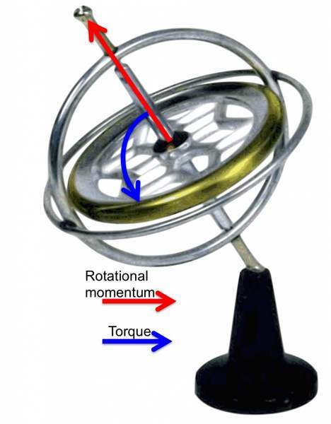

Hi,
I'm having some trouble understanding how this works. I'm trying to put the pieces together but I'm hoping people here can help me. Specifically I'm wondering about a gyroscope positioned so that its axis lies in the horizontal plane and one end sits on top of a rod. So far what I've got is this:
There is a torque acting at the centre of mass of the gyroscope. Torque equals the rate of change of angular momentum, and so the angular momentum of the gyroscope must change so long as there is a torque acting.
Angular momentum must be conserved. I'm not really sure how that applies here. Maybe this is why I'm having trouble.
The main problem I'm having is this: It sounds logical when somebody else says it, but I can't seem to properly understand it myself. If this works on a gyroscope, why doesn't it work on a stationary rod (this still has a torque acting?). In this case the rod would gain angular momentum in the vertical plane I guess, due to gravity. So then if the rod is spun, like a gyroscope, it should precess as well? Maybe it does a little bit, but no matter how thick or heavy or long the rod is, it will always fall pretty quick. So why is this different for a gyroscope?
I've been thinking and thinking but I just can't really clear it up. Any help appreciated. Thanks.

jbar18 said:
Now torque gives us the rate of change of angular momentum, and so since there is a net torque, the angular momentum of the gyroscope must change. However, angular momentum must also be conserved, and so as a vector quantity, the angular momentum will stay at the same magnitude but will change direction.
There are at least two things wrong with your thinking here.
One is that when angular momentum is conserved, it is the vector quantity, not just the magnitude, that is conserved. The other problem is that angular momentum is not conserved here. There are external torques.
To help clarify things, let's look at linear momentum. An external force acting on an object changes the linear momentum of that object. So doesn't this conflict with the fact that linear momentum is a conserved quantity? Of course not. Linear momentum is a conserved quantity in an isolated system. A object that has external forces acting on it is not an isolated system. Conservation of linear momentum does not apply to this object.
The exact same thing happens with respect to angular momentum when external torques act on some object. The object is not an isolated system. The law of conservation of angular momentum does not apply to this object.

Before I finish my epic math quest, is this what you are looking for?
So, using the right-hand rule, the vector for rotational momentum points up along the gyroscope's axis. Now, when gravity tries to rotate the gyroscope, it also has to rotate the rotational momentum vector. Because gravity is changing the momentum, it requires a force (torque in this case) to overcome inertia. If gravity has enough torque, it can do work on the gyroscope and it will fall and the rotation will slow. If gravity does not have enough torque, the gyroscope will stay up and keep rotating. It is like Newton's second law: it takes force to change momentum. It just happens that our force and momentum are rotational, meaning that the vectors point in weird ways.
See the image:
