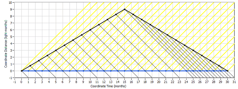

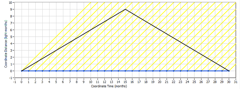

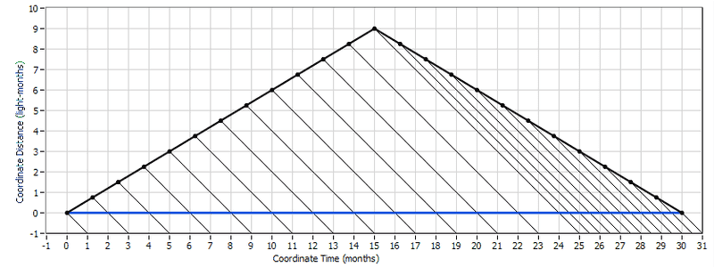

#65
Dec4-12, 02:37 AM
PF Gold
P: 4,737
Quote Quote by greswd View Post
How do we draw a graph to describe that from Adam's perspective? It is this graph
It shows a highly implausible scenario.
Quote Quote by ghwellsjr View Post
I agree, your third graph is implausible.
I have a suggestion: let's change the scenario to one that you can accurately draw graphs for. So let's change the speed of Adam to 0.6c. This will make the redshift Doppler factor be 0.5 and the blueshift Doppler factor be 2.
Adam will go for one year away according to his clock and one year returning. He will emit a flash of light every month for a total of 24, 12 on the way out and 12 on the way back. He will see the flashes coming from Charles at one half that rate on the way out for a total of 6 and for double that rate on the way back for a total of 24 more and a grand total of 30.
Charles will emit 30 flashes during the time that Adam is gone. Since he will be seeing Adam's flashes coming in at one half his rate and since he sees Adam turning around when he sees the 12th flash from Adam, he will be emitting his 24th flash at that moment. Then he sees the flashes coming in at double his rate for 12 more flashes from Adam while he is emitting 6 more. His total is again 30 while Adam's total is 24.
Please redraw your first two graphs using these numbers, make sure the slope of Adam's path is accurate for 0.6c and the rate of Adam's flashes are spaced farther apart by a factor of 1.25 compared to Charles's flashes to take into account his time dilation.
Then after you make those two graphs, make a third graph that is simply an overlay of the first two graphs. This is how you can show the Doppler effect and this one graph will show accurately the perspective of both Adam and Charles in terms of what they see compared to their own clocks.
As promised, here are the graphs that I suggested that you make. The first graph is similar to your first graph except I haven't shown dots along Adam's path (black) to show where he receives signals from Charles (blue with yellow signals) because they are uncalibrated:
Similarly, I haven't shown dots along Charles's path (blue) to show where he receives signals from Adam (black):
Finally, I suggested that you overlay these two graphs to get a correct third graph that shows everything, including Adam's perspective:
Note that we can now see Adam's time dilation. Since his speed is 0.6c, gamma is 1.25 and his tick marks are spaced at 1.25 of the coordinate grid. This illustrates that his Proper Time is equal to gamma multiplied by the coordinate time. You can also see that he sends a signal to Charles at every tick but during the outbound portion of his trip, he receives the signals from Charles every other month corresponding to a redshift Doppler factor of 0.5.
Charles is also sending out a signal every month to Adam but since he is stationary in this frame, his Proper Time is coincident with the coordinate time. Still, you can see that he receives signals from Adam every other month at the beginning. His redshift Doppler factor during this time is also 0.5.
Charles continues to see Adam' clock running at 1/2 the rate of his own until he sees Adam turn around when Adam's clock reaches 12 months. This occurs when Charles's clock is at 24 months. From then on, he sees Adam's clock running at twice the rate of his own for a blueshift Doppler factor of 2 so that in 6 more months of his own time, he sees Adam's clock adanvce by 12 months. At the end, he has seen Adam's clock advance 12 months in slow motion and 12 months in fast motion for a total of 24 months.
Meanwhile, Adam has been watching Charles's clock advance at 1/2 his own rate (redshift Doppler) so that after one year of his own time, Charles has advanced by 6 months. When he turns around, he sees Charles's clock advancing at double the rate of his own (blueshift Doppler) so that in the one year that it takes him to return, he sees Charles advance by 2 years for a total of 30 months.

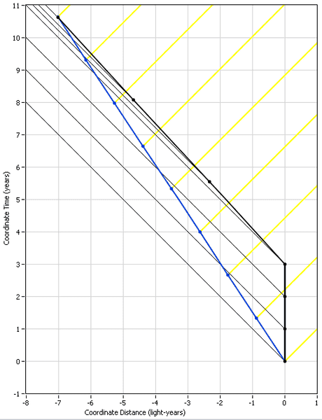

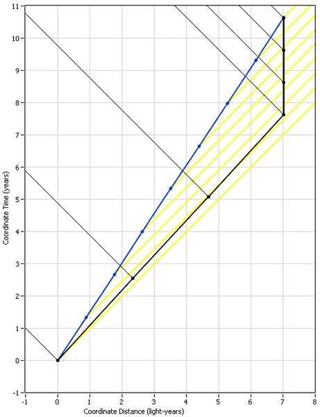

Sorry for taking such a long hiatus. I was very busy with other matters. Anyway, I understand the diagrams well.
With regards with my rejected 3rd diagram. I found this from UNSW that looks very similar.
http://www.phys.unsw.edu.au/einstein...in_paradox.htm
Their first diagram looks very similar to my third diagram above because we both combined the signals from both twins to show how they were received by the other twin. That's what I was trying to get you to do but you never did, not even in your third diagram so how can you say yours is similar to theirs?
They did a better job on their first diagram compared to the one shown in post #34 from wikipedia but it's still not perfect. Here's what it should look like:
They show Joe 7 after he receives the signal from Jane 3 but he should be slightly before. Note also how they show Jane 5 receiving the signal from Joe 6 at the same time but she should be slightly earlier. In fact these two situations should show the same relationship because it is a reciprocal Doppler shift.
And their second diagram is wrong, not to mention ridiculous. They should show Joe 2 on the bottom diagonal and they should show Joe 6 on the top diagonal. Here is the diagram for the frame in which Jane is at rest during the outbound portion of her trip:
And here is the diagram for the frame in which Jane is at rest during the inbound portion of her trip:
What they were trying to do is combine the bottom part of the outbound portion of the trip with the top part of the inbound portion of the trip while showing in dotted lines the signals coming from Joe. They did a fairly good job of that but why don't they correctly show the signals going to Joe from Jane? They do show all five of Jane's signals but if they had shown Joe 6 at the correct location he would have received the signal from Jane 2 after the correct position for Joe 6 and it should be coming between Joe 4 and Joe 5 as they indicate in their first diagram.
It is impossible to combine the two parts of the outbound and inbound portions of Jane's two rest frames into one like this. If you're going to do it correctly, you need a much more complicated diagram. You need to show the correct Doppler signals for both twins throughout the diagram, just like all three of my diagrams show. It's so easy to do in an Inertial Reference Frame, why do you feel the need to do it in a non-inertial frame?

ghwellsjr
#72
Jan11-13, 01:48 PM
PF Gold
P: 4,737
@ghwellsjr so are you saying that UNSW got it wrong?
Yes, that's what I said, wrong and ridiculous. Don't forget the ridiculous part.
I said their first diagram is close to being right but their second diagram is wrong.
If they had used their second diagram to show just the messages coming from Joe to Jane they would have made a diagram that was more like the one DrGreg made in post #39. Note that he is only showing the messages going from the inertial twin to the traveling twin. That part of the diagram, as I already stated, is fairly good.
But the part that is completely wrong is where they also try to show the messages going from Jane to Joe. If you look at their first diagram, you can see that Joe receives these messages at two different rates. The first three messages take over two years each for him to receive, then in his last year he receives all the rest of them. They show this pretty close to being right and it's important that a diagram show that the inertial twin receives half of the messages at a slow rate and half of the messages at a fast rate and it's important to show that the time interval over which he receives those message is not evenly spaced. He spends way more of his time receiving the low rate messages and only a short time near the end receiving the high rate messages.
It's also important that a diagram show that the traveling twin spends exactly half her time receiving the low rate messages during the outbound portion of her trip and the other half of her time receiving the high rate messages during the inbound portion of her trip. They do a good job of showing this aspect in both diagrams.
However, if you look at their second diagram, you see that Joe does not receive any messages until half way through the diagram at which point he receives all the messages from Jane equally spaced in time. It's the correct spacing in time for the last messages but not for the first three. It's faster than it should be. This is wrong and it's a ridiculous concept to try to show on a combined diagram like this. In fact, I have no idea how to correctly show Joe receiving the messages from Jane at the correct rates and to show the transmission of the signals traveling at c between the two twins. I'm not saying it can't be done, just that I don't know how to do it.
And again, I ask you, why do you feel compelled to combine portions of two perfectly good Inertial Reference Frames into one ridiculous monstrosity? Why not just show everything in each one of the Inertial Reference Frames like I did in post #67?
