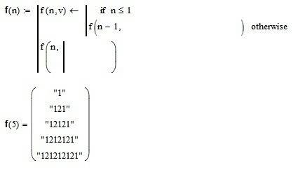

Actually, it is really as easy as it looks. Paradoxically, it may be helpful to regard it as a special case of:
1 2 3 ...n 1
1 2 3 ...n 1 2 3 ...n 1
1 2 3 ...n 1 2 3 ...n 1 2 3 ...n 1
1 2 3 ...n 1 2 3 ...n 1 2 3 ...n 1 2 3 ...n 1
1 2 3 ...n 1 2 3 ...n 1 2 3 ...n 1 2 3 ...n 1 2 3 ...n 1
which is only marginally more difficult to program but may be easier to think about because it's more general. Look up the C operator "%"
Here's an example output from a Mathcad function, which is written in 5 (completely invisible and very short) lines

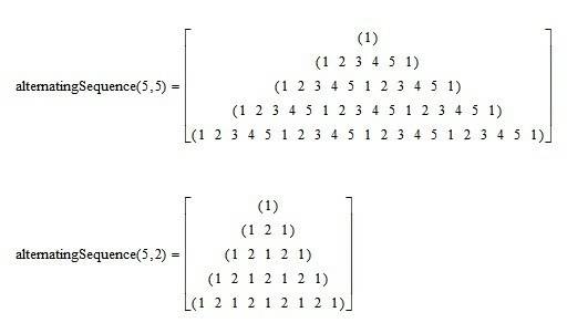

Umm ... I suppose that depends upon one's definition of "straightforward". It took 2 loops in Mathcad using an algorithm that should readily port into C. The original can be done in one loop - here's a Mathcad string variant of the original, showing the single loop ...
The "Christmas Tree" effect is due to Mathcad's method of formatting arrays and isn't a programming artifact.

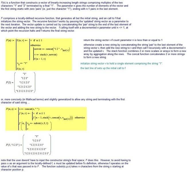

Following on from the above, how is it more challenging? The Mathcad function that I showed the outline for passes information in the arguments.
What I'm thinking about most in this whole discussion is not what's the best way to construct the tree diagram, but what the purpose of the whole exercise is, i.e. what is the student supposed to learn by solving it?
Without the "student" input, I see it as a cat-skinning exercise o:)
(The OP may very well know about loops but just have been having a "Doh!" moment or looking for non-existent "traps" in a straightforward problem (been there, done that and worn holes in the T-shirt!))
