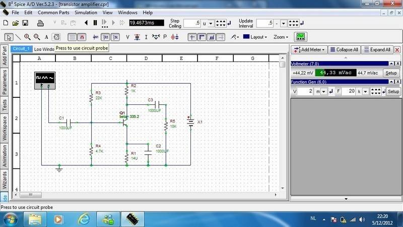

  • #110
michael1978 said:
thank you very much
joney is correct this amplifier, he give voltage gain of 44mv not 50mv
  • #111
I don't know. You need to tell me the bias point collector current and BJT model that you use.

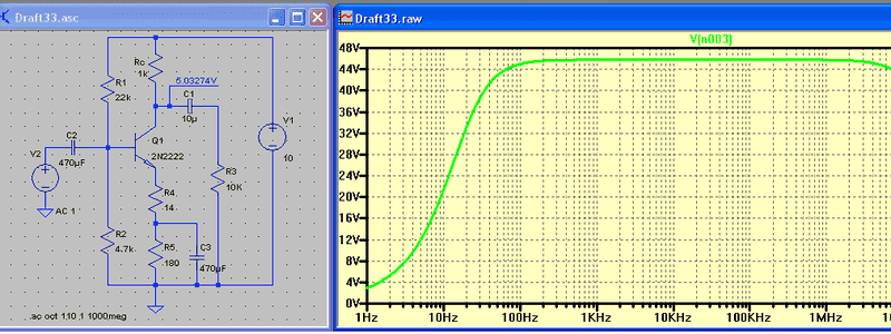

  • #112
this your example i just simulate (do you see the foto the value) in quote 69
Vb = Ve + Vbe = Ic*(Re1+Re2)+ Vbe = 5mA* (180 + 14) + 0.65V = 1.62V
If we assume Hfe = 150 I (I use transistor 2N3903 I don’t know other there are a lot of types)
Ib = Ic/hfe = 5mA/150 = 34μA
R1 = (Vcc - Vb)/( 11*Ib) = 22KΩ
R2 = Vb/(10*Ib) = 4.7KΩ
Re1 = Rc/Av - re = 1K/50 - 5.2Ω = 20 - 5.2Ω = 14Ω
  • #113
But your circuit is different than mine. Also you can read from simulation DC collector current.
And your circuit has a voltage gain equal to:
Av = Vout/Vin = 44.33mV/2mV = 22.165[V/V]
My example look like this:
And has a voltage gain Av = 45.8V/V But we can easily change the voltage gain by changing the Re1 resistance.

  • #114
can you explain how you can change the voltage gain by changing Re1
Joney do you remember i ask you to make one amplifier with voltage gain of 50, only we Re1 Without Re2,
and you show me this example, look at quote 66, IF YOU HAVE TIME.
Re1 = Rc/Av - re = 1K/50 - 5.2Ω = 20 - 5.2Ω = 14Ω, and i think you did not show me complete example, becuse i am searchin here but i can't find,
do you remember now Re1 = Rc/Av - re = 1K/50 - 5.2Ω = 20 - 5.2Ω = 14Ω
for the rest value i think of maybe i misunderstand , are the same like this circuit the last one... if not ? PLEASE CAN YOU MAKE ONE EXAMPLE ONLY WITH Re1 PLEASE THNX
  • #115
I did not read the whole thread. Remember when I left off, I showed you how to calculate the gain? It's the impedance seen at the collector divided be the impedance seen by the emitter? Adding C2 don't change this, the total emitter resistance is
r'e+ Re1+(Re2//Xc2) where [itex]X_{C2}=\frac 1 {j\omega C}[/itex]
You change the Re2, you change the impedance on the emitter side and change the gain.
