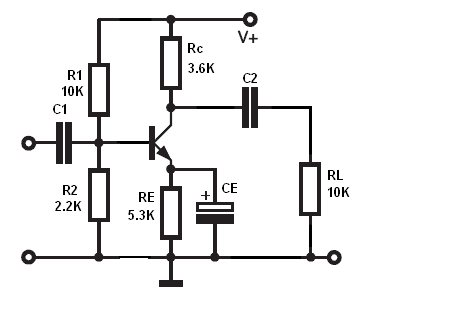

may i ask you something
FIRST
is this formula OK
for example rc=(3.600X10000)/(3600+10000)=2650
desired voltage 0.5, 2650/0.5=5300 so re=5300
voltage gain is 2650/5300=0.5
is this correct formula? if is this is correct formula why my simulator is 43mV not 50mv
where is wrong my formula of my simulator? can you exaplian me please thanx
SECOND how if you connect one re in serie with r'e, how decrase voltage gain, can you explain in similary ways please

Jony130 said:
Show as a diagram and all components values.
And tell as how long you have been learn electronics?
long enough,
rc=3.600
rl=10000
re bypass 5300, only 1 resistor in parallel with capacitor
voltage divider
r1=10000
r2 = 2.200
power supply 10v
input voltage 2mv at frequnecy 20K
  • #32
If I understand you correctly your circuit look like this:
and Vcc = 10V
If so the collector current is equal to
Ic ≈ Ve/RE ≈ 1.1V/5.3KΩ ≈ 0.2mA
and Vc = Vcc - Ic *Rc = 10V - 0.2mA * 3.6K = 10V - 0.72V = 9.28V .
And the voltage gain
Av = (Rc||RL)/re = 2.65KΩ/130Ω = 20[V/V]
And
Vout = 20* Vin = 20 * 2mV = 40mV
But your amplifier Q point (bias point) was not chosen properly.
See this post
https://www.physicsforums.com/showthread.php?p=4058469#post4058469
Where
re = 26mV/Ic
Ve = (Vcc* R2/(R1+R2)) - Vbe
And next time try use Engineering notation instead of 3.600

sorry i am a beginner
my circuits look like that,
but when you start to build an amplifier, which are the first steps to take
and how to get a desired voltage,
i so my amplifier is bad, but is was good the re was 1k but me i changet to experiment to get desired voltage
what do you think, do you have time to build one amplifier with desired gain, can you show step by step and to explain in similary way please
And
See this post
Where
re = 26mV/Ic
and how you get 130Ω? Av = (Rc||RL)/re = 2.65KΩ/130Ω = 20[V/V] PLEASE CAN YOU TELL ME YOUR CALCULATION
