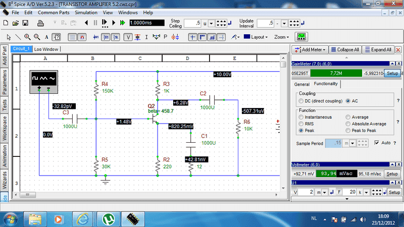

We need Re2 resistor simply because it is almost impassible to build amplifier with desired low voltage gain and Ve > Vbe. Which is needed for good bias point stability.
But if you determined to use only Re1 resistor. We need to change DC bias method.
So we are not going to use voltage divider, instead of voltage divider we will use a collector-feedback bias circuit.
So for our example for Vcc = 10V and Rc = 1K;RL = 10K; Ic = 5mA and Av = 50.
re = 26mV/Ic = 5.2Ω
Re1 = (Rc||RL)/Av - re = 909Ω/50 - 5.2 = 12Ω
Vc = Vcc - Ic*Rc = 5V
Vb = Ic*Re1 + Vbe = 0.71V
And
Ib = Ic/hfe = 5mA/150 = 33.4μA
Rb1+Rb2 = (Vc - Vb)/Ib = 4.29V/33.4μA = 128KΩ
Rb1 = Rb2 = 128K/2 = 68KΩ
And simulation show that voltage gain is equal to AV = 51.8092[V/V]

HI Jony how are you, may i ask you something, the schematic of designin of amplifier , you make it with light spice of some other software , because you told me i use light spice,
greetings
And
