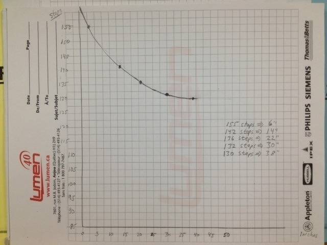

In my spare time I am fiddling around with proximity sensors. I have a proximity sensor that accepts 135 steps. Therefore, when I am at step 135, the sensor is able to detect an object 0 inches away. When I am down at step 0, the sensor is able to detect an object at 135" away which is the maximum distance. So as you can see the higher the steps, the shorter the distance an object can be detected by the sensor.The lower the steps the further the object can be detected by the sensor. The problem is that the relation is not linear, its exponential?
Therefore I need to make a relation between the number of steps and inches. Please view attachment for an example of the curve set by the steps vs the distance!

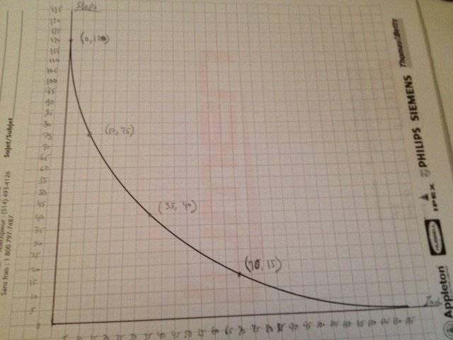

Here are some definite coordinates that I measured:
(0, 120)
(10,75)
(35,40)
(70,15)
My question is, how can I develop a mathematical model (formula) so that just by looking at a step value I would be able to calculate the respective distance without looking at the
graph?
Thank you all for your help.

The graph that you have drawn looks like a re-scaled circle (i.e. an oval or ellipse) with vertical and horizontal tangents at (0,120) and (135,0) respectively.
If one hypothesizes that the center is at (135,120) and that the distance metric in the x direction is scaled down by a factor of 120/135 then a possible equation is:
(120/135 (x-135))^2 + (y-120)^2 = 120^2
You are probably better served by starting with a physical rationale for a curve of a particular form, parameterizing that curve in terms of several numbers and then performing a regression to see what set of parameters makes the resulting curve best fit your measurements.

I picked the curve type by eyeballing it. It looked like a circle tangent to the x and y axes and centered at (135,120).
Of course, that's impossible. But it could be a slightly flattened circle. The formula for a circle centered at (i,j) of radius r is
(x-i)^2 + (y-i)^2 = r^2
A circle centered of radius 120 centered at (120,120) is then
(x-120)^2 + (y-120)^2 = 120^2
Scale up the x-axis by a factor of 135/120 and this becomes
Now, by my count you are fitting a curve to seven data points:
(0,120), (10,75), (35, 40), (70,15), (135,0), an assumption that the slope is infinite at (0,120) and an assumption that the slope is zero at (135,0).
There are infinitely many curves that fit those seven data points. If you can pick a particular family of curves there will be a family member that best fits the data. The trick is picking the right family.
If you pick the wrong family of curves you can wind up with something like "epicycles". That was an attempt to model planetary motion as circles within circles within circles. Add enough layers and enough parameters and you can always fit the observed data. But switch to using ellipses as the model and you can fit the data with only a couple of parameters.
One measure of a good model is one that can fit the observed data with a minimum number of adjustable parameters.

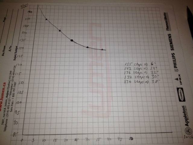

Hello jbriggs444,
Okay, I have not had the time to really look at your last post yet... But I will do so as soon as I can. In the meantime I have re-measured the values from the sensor and you may view the actual values in the new attachment below. Now my question is, in which category of curves does something like this fall in!
I would have to modify your equation a little I suppose... Please take a look at it and let me know if I can still use your equation! Tonight, when I get home, I will re-read everything and try to figure it out... But I still need your help, because I am sure I will have some relative questions!
Thank you so much

P.S. the last plot you posted is missing 150 on the vertical axis.

But this shape, isn't it from the parabola family?? for example:
x^ + 2ax + a^
Please view better curve attachment. After all the vertex seems to be (38, 130)!
That's exactly what jbriggs444 did. The example data you provided looked like a circle. In the second case, it's not clear that a circle is an appropriate model (my guess is no). Choosing a model isn't trivial. There are curve fitting programs out there (google searches would find them) that will check a variety of equation types and determine the best fit among the equations it tries, but that may or may not provide a satisfactory result.

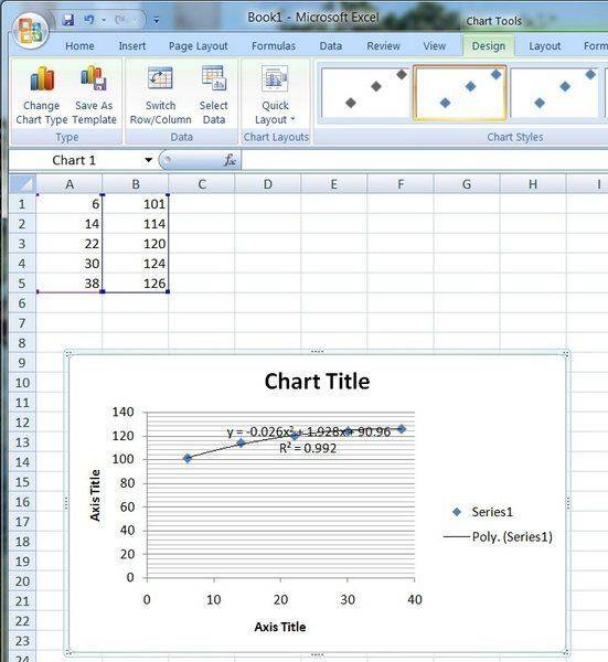

I have Excel 2010 and it has curve fitting functions that are straightforward to use:
I have excel... under which menu?
I don't know if learning matrix, transpose, inverse, solving a set of linear equations would be easier to do then have excel do it for me...
Telling someone to use excel to do this is still quite complicated...
Excel asks to select a function out of a hundred or so functions... still not easy to do! :biggrin:
simpComp, these are the instructions of fitting a line in Excel 2010:
First fill two columns with both your observation values.
Then, select both columns and go to Insert-Scatter and click the first type.
Now you need to fit a line on those points:
Click the graph and go to Chart Layout and select the type that has a "fx" symbol.
You got a linear fitting by default. To change it, you need to click the line, then right click and go to Format Trendline...
There you can choose the line that fits best to your data.
EDIT: See the next posting, that no use of any matrix nor linear algebra were necessary.

So, I followed your instructions and I got the following graph as shown in the attachment showing the Excel spreadsheet. So it seems that the million dollar equation that I have been searching for is:
y = -0.026x^2 + 1.928x + 90.96
I was off with the middle sign trying to do it as:
y = ax^2 - bx + c ?
How is one supposed to know that the middle sign would be a "+" instead of a "-"??

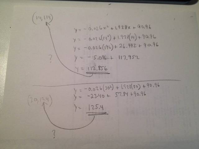

Any how, based on my other attachment, the calculated values from Excel's equation seems to be a little off. I did it for two coordinates and in each one the answer is off by approximately 1.5??
Is this normal? Is it because of truncated precision in the decimal numbers... If so is there a way to increase this precision?
Also, in the graph generated by Excel, what is R2?
Thanks for your help!
