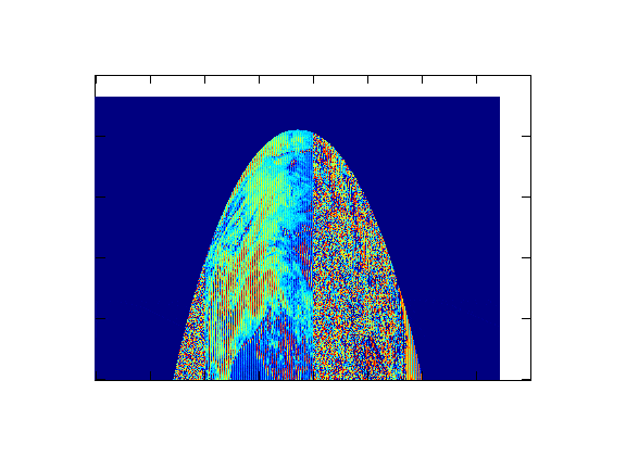

I'm having a bit of trouble converting an 8 bit stream into a 10 bit one.
First i create intvalbin8, a Nx8 zero/one array where N is the byte length of the input data:
(6198 is the header offset factor)
Code:
j=1
do while (intvalout(i).gt.0)
 intvalbin8(j,i-6198)=modulo(intvalout(i),2)
 intvalout(i)=floor(real(intvalout(i))/2.)
 j=j+1
end do
Then i (hopefully) reshape it into a Nx10 one (intvalbin10) :
Code:
intvalbin10=reshape(intvalbin8,shape(intvalbin10))
Transforming it into 10 bit integers with:
Code:
intvaldec10=0
do i=1,size(intvaldec10)
 do j=1,10
  intvaldec10(i)=intvaldec10(i)+intvalbin10(j,i)*2**(j-1)
 end do
end do

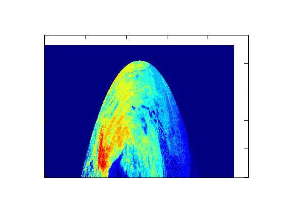

In my case this is a column of values, corresponding to a 3712 x 464 array.
The problem is that it somehow messes up the ordering od the indices.
When printing out only every fourth line, the image looks "fine".
(this is the most decent looking out of the four subsets)
This is the full, jumbled array
I have no clue whatsoever what is wrong here. I've tried transposing,flipping... the 8bit one while reshaping it, but to no avail.
Any help is much appreciated.
Kind regards,
Marko

I don't understand what you are trying to do.
Can you show me an original "5x8" matrix, how it is supposed to look like and then show me how it is that you expect the 4x10 matrix to look like?
I am choosing a small matrix to so that you can put it all together by hand, of course.
Oops...I just realized that your Nx8 matrix is 2D and your 10-bit is a column vector...so, show me an original 5x8 and the corresponding expected vector...
When reading data from a binary file, i only know how to read it in 1 byte chunks.
The file's header is written in this format (first 6198 entries), but the rest of is in 10 bit format.
That is why i opted for transforming the 8 bit stream into a 10 bit one, and then calulating the int values of the 10 bit one.
So, at first i have a an array Nx8 binary values:

A more elegant solution would be just to read the file in 10 bit chunks, but i am not sure how to do it. Is there a way of defining integer variables which are 10 bits in size?
Hopefully I've made it a bit more clear.

Assuming you have enough ram, it might be easier to read in the entire file into memory, then parse the binary image into 10 bit values, using a bit and byte offsets, and using 2 or 3 bytes in a row to pick up 10 bit values.
The bit offset would go from bit 0 to bit 7, and the byte offset would increase each time the bit offset increases over 8, where you subtract 8 from the bit offset and add 1 to the byte offset. After picking up a 10 bit value, you add 2 to the bit offset, and 1 to the byte offset. If the bit offset become 8 or greater, subtract 8 from the bit offset and add 1 to the byte offset.
The 3 byte case occurs when the bit offset is 7, but you could always pick up 3 bytes and end up effectively shifting the 3rd byte bits off the end most of the time. The code would look something like this
assuming you have a byte array that contains the binary image of the data as unsigned characters, and that integers are 32 or 64 bits:

Note if bit offset can never start on an odd bit boundary, then you only need to deal with 2 bytes at a time, readling would look like this:
mem0 = mem[byte_offset]
mem1 = mem[byte_offset+1]
xbits = (mem0*256) + mem1
xbits = xbits / (2**(6 - bit_offset))
x10bitvalue = modulo(xbits, 2**10)
