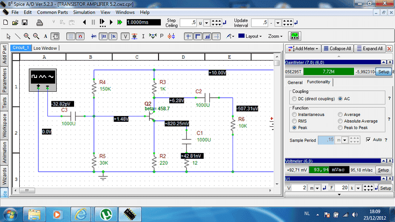

look my circuit, i dont know where i make mistake, normal gain have to be 50*2Mv=100mV Peak

It's not a very good design. For bias point stability (against VB and variations) you should allow a couple of volts across the emitter resistor; you have just 0.4V.
For maximum symmetrical output swing, you should allow approx as much voltage across RC as VCE. But you have ~1.8V and 7.8V, resp.
At what frequency are you measuring the ac gain?

No the design is good. Simply the BJT that michael1978 use in his simulation has a very low current gain.
Ie = 0.4V/220Ω = 1.8mA
And Ib = IR4 - IR5
IR4 = 1V/30K = 33.4μA
IR5 = (10V - 1V)/150kΩ = 9V/150KΩ = 60μA
So Ib = 60μA - 33.4μA = 26.6μA
And Hfe = β = (Ie/Ib - 1) = 66.6
And this circuit was design for Hfe > 420

66 is a BJT current gain, not a amplifier voltage gain.
So in order to make this circuit work properly. You need change the BJT that you use in your simulation program. You need to find the BJT with Hfe > 300 in your simulation.

ah 66 is curent gain, so you mean to change type of transistor, but is possible for you to tell me any type of transistor wich work, because there are a lot of type of transistor, and somebody he tell me one type of transistor but that transistor dont exist in my list of transistors
and yes Jony if you can tell me, i try to find self soms but i cant find it, that is the problem

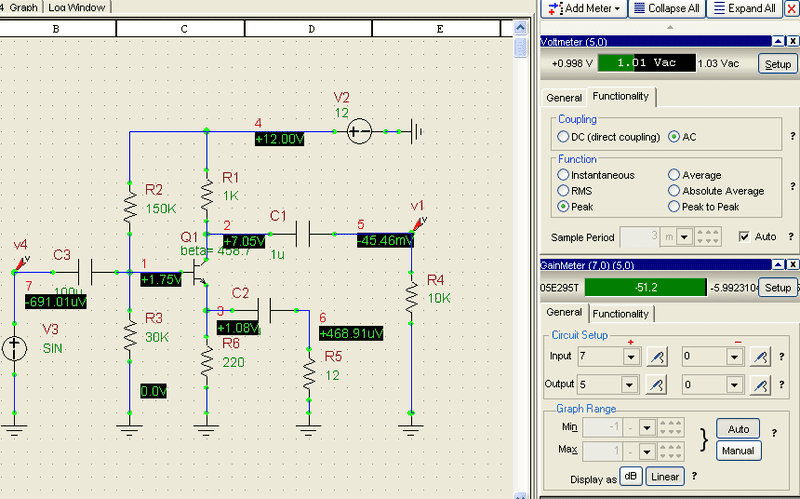

BC548C
What simulation program do yo use ?

P: 133
Quote Quote by Jony130 View Post
BC548C
o joney i dont have, i have bc548A but not BC548C, i use B2 Spice A/V

hey Jony i try with bc548A, and i get voltage gain of 84mv is this correct?

yes Joney i have that type i change, and now voltage gain is 94mv is correct now?
Jony130
Jony130 is offline
#198
Dec23-12, 09:56 AM
P: 389
Well first you need to learn how to use the simulation program.
I use B2 Spice V5 and as a BJT use BC547C. And AC sweep analysis show that voltage gain is equal to 50.1V/V
For 20mV at input I get 1V at output.
