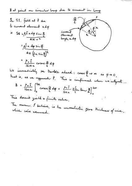

Well, fools rush in where angels fear to tread. I found both setting up the integral and integrating it (courtesy of Wolfram) ominously straightforward. Unfortunately it gives an infinite value for the field at at a point on the loop, due to the whole loop. We know this not to be the case. I fear that we must consider the finite thickness of the wire - and that is a path down which I shall not venture...
[Note: in the thumbnail I should have called the current element Ia d[itex]\phi[/itex].
I should also have stated that the fields at P due to all the elements are in the same direction, namely out of the page if the current is anticlockwise.]

Ya I came to the same conclusion, that the field depends on the thickness of the wire, because the strength inside is proportional to radial distance from the center over radius of the wire squared:
http://webphysics.davidson.edu/physlet_resources/bu_semester2/c15_inside.html
Again, everything breaks down for a 0 thickness wire. I think the self field will be 0 at the center of any wire, regardless of thickness though.
However, we know that there is definitely a force from the rest of the ring because we can calculate it for parallel wires, and we know that the force MUST be greater than or equal to the parallel case because a bent loop will have some interaction with the opposite side (like the focus of a parabola), and the bent neighbors of an infinitesimal length will have little to no interaction because they are nearly parallel to the segment. I'm confident that force per length will be somewhere between 1 and 2 pi times stronger than for the parallel case.

I'm going to list Philip's solution here to build from:
B = (u0*I/16*pi*r)*2*[ln(tan(phi/4))] from phiStart to phiEnd
So for a complete circle, it's from 0 to 2pi. But tan of 2pi/4 is infinity.

For an infinite parallel wire, Ampère's circuital law (+ symmetry) shows that the field outside the wire is the same as if all the current flowed along the axis of the wire. I suspect that the motor effect force on the other wire is as if the current flowed along its axis, but I'm not sure on this point. Any departure from the force calculated assuming axial flow would certainly be very small if the wires are much further apart than their diameters.
The problem with the loop integration arises near the limits ([itex]\phi = 0, \phi = 2\pi).[/itex] The r2 term on the bottom drives the integrand towards infinity more powerfully than the sin[itex]\frac{\phi}{2}[/itex] on top drives it towards zero.

You have done a nice job there.
I occurs to me that the Biot Savart law as I have written it is not really applicable when you get close to P (ie. r → 0) because the magnetic field reaches a maximum just outside the wire (B = μ0I/∏d where d is the diameter of the wire) and when you go to smaller distances you have to take into account current density in the wire. When you get inside the wire there is no enclosed current so the B field is 0. So when the angle in your integral is such that line from dl to P passes entirely through the wire, the field contribution ≈ 0. You could work out when that would occur (call it angle δ) and just set the limits of integration from 0+δ to 2∏-δ. For starters, just let δ=2∏/360 and try running that through your calculators.
AM

Using the formula for L given in post 16, I obtain:
[itex]\frac{F}{s} = \frac{\mu_0 I^2}{2 \pi r} (ln\frac{8r}{a} - \frac{3}{4})[/itex].

After mulling over this problem for another couple of days and not getting anywhere, I decided to go back to basics and look at the magnetic force between moving charges:
http://teacher.nsrl.rochester.edu/phy122/Lecture_Notes/Chapter30/chapter30.html
[itex]\bar{F} _{mag} = \frac{\mu_0}{4\pi} \frac{q _{1} q _{2}}{r^2} \bar{v _{1}} \times (\bar{v _{2}} \times \hat{r})[/itex]
Where [itex]\bar{F} _{mag}[/itex] is the force vector, [itex]v _{1}[/itex] and [itex]v _{2}[/itex] are the velocity vectors of the charges respectively, and [itex]\hat{r}[/itex] is the unit vector from [itex]q _{1}[/itex] to [itex]q _{2}[/itex]
I'm going to list the contributions [itex]F _{12}[/itex] and [itex]F _{21}[/itex] from Tipler Physics 25-3a and 25-4b because I'm having trouble finding them on the web:
[itex]F _{12} = q _{2} v _{2} \times B _{1} = q _{2} v _{2} \times (\frac{\mu_0}{4\pi} \frac{q _{1} v _{1} \times \hat{r} _{12}}{r^2 _{12}})[/itex]
[itex]F _{21} = q _{1} v _{1} \times B _{2} = q _{1} v _{1} \times (\frac{\mu_0}{4\pi} \frac{q _{2} v _{2} \times \hat{r} _{21}}{r^2 _{21}})[/itex]
I'd like to integrate these inside a rectangular cross section ring and also a torus for a given charge velocity, which can be derived from current:
http://en.wikipedia.org/wiki/Electric_current#Drift_speed
[itex]I = n q v _{d} A[/itex]
So basically, if we assume an even charge distribution, we could calculate the sum of the forces from the other charges on a single charge and then sum those to get the total force.
I might just do this numerically with a finite number of point charges evenly distributed in the ring for now as a check for Philip's #19 formula.
The $64,000 question for me is whether the outward force depends on the cross sectional area A of the ring. I would also like to know if the shape of the area around the centroid matters (my guess is that it won't). Hopefully we can get a thin wire approximation out of this for ring radius >> thickness.

The Lorentz force for current: F = ILB = B∫jLdA = B∫jdV where j is the current density in the conductor, L is the length of conductor, A the cross-sectional area, dV is the volume differential and B is the magnetic field external to L (ie. it does not include the field created by the current flow in L). To use this, one would to know the current density as a function of volume. I don't think you have to determine the drift velocity of the electrons.
You are making it more difficult than it is. The difficult part is determining B, not I or the Lorentz force. Just use dF = IBdL or dF/dL = IB where B is determined by the Biot-Savart formula.
