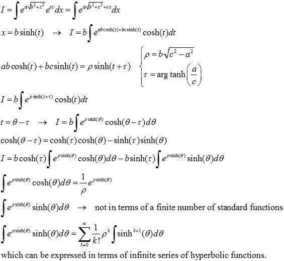

Integral of exp[a*sqrt(b^2+x^2)]*exp(c*x)*dx
this integral cannot be expressed in terms of a finite number of standard functions, but in terms of tough series of hyperbolic functions. See attachment.
The formal result will be so ardeous that I doubt that it could be useful for further calculus in practice.
So, I suggest to use numerical methods instead of analytical.

phys_student1
#12
Feb17-13, 10:14 AM
P: 96
Quote Quote by JJacquelin View Post
Hi !
Thanks indeed!
Yes I tried a lot but have not find any good result and you confirmed this. Thanks for your effort, I really appreciate your time! Thanks again.
