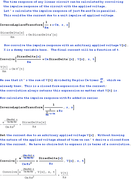

In an earlier post, I showed how to get the impulse response for your circuit including Rs. That essentially solved the equations you've got here.
uart says:
"It can but that will give you a DE instead of a closed form solution. The DE you obtain is :
[tex] (R_1+R_2) \, i + R_1\, R_2\, C \, di/dt = v + R_2\, C\, dv/dt[/tex]
In general you'd need to specify the input voltage as a time function, v(t), and solve the above DE."

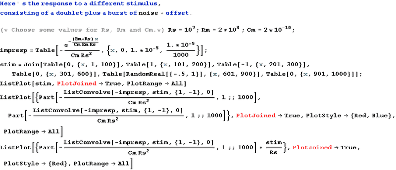

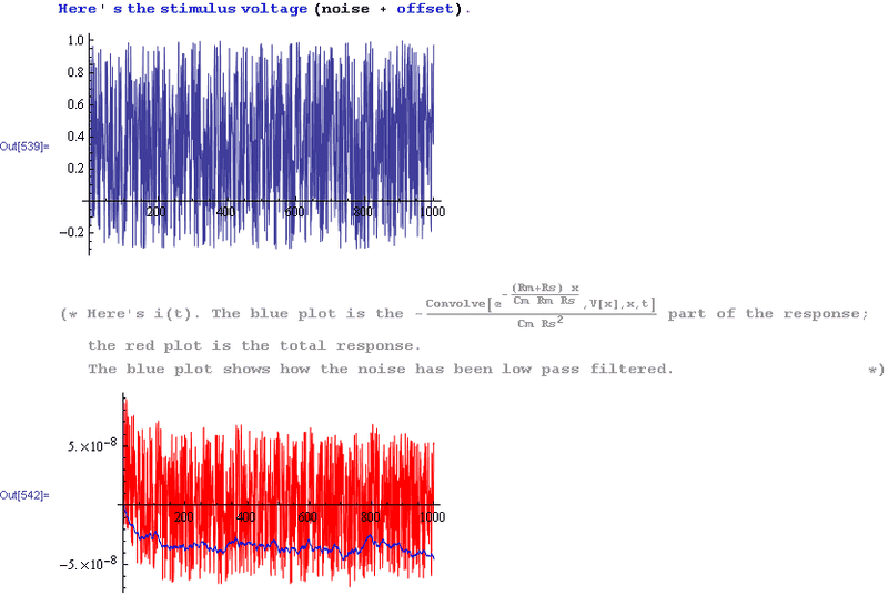

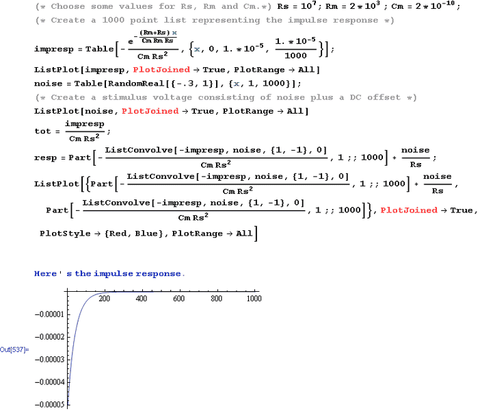

This is quite true, but "in general" you won't be able to "solve" the DE in the traditional way for an arbitrary input voltage. But, a general "solution" for arbitrary Vcmd can be found using convolution. I showed it in formal terms in the previous post, but now let me show a practical example.
See the attached images in this post for one example, and the images in the next post for another example.

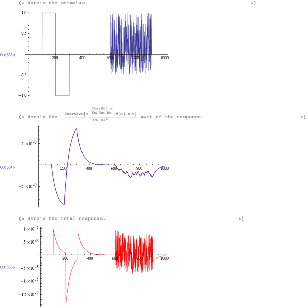

Here's a second example.

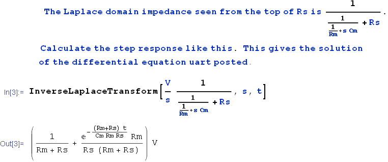

The easiest way to come up with this is to solve the network. Use Kirchoff's voltage law and you get two simultaneous equations which resolve to this one.
Also, Laplace transforms can be used to get the step response of the network, which is the solution of the differential equation just above. See the attached image.
But, if you want i(t) for anything other than a mathematically simple stimulus such as a step, or a sine wave, you will probably have to use the convolution theorem.
