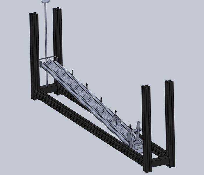

I have attached a cad picture to this post of what i have for a preliminary design. (very Early) the airtrack will have modifiyable angle of incline via a leadscrew. I am also looking at the use of reed swith magnet circuids and bicycle pedometers for the measurement of the slider postion times. We're also looking into a laser. but what you see along the edge of the track are small magnets.

I don't know what your brief is but I would suggest that air flow and pressure problems were the last thing you needed to worry about.
The only other practical advice that I can offer is that the holes along the sides of the track should be towards the edges of the riders, I would say about 2/3 of the way from the apex. Thefirst one I made had the holes near the apex and the riders tilted and touched the track. I blocked these holes with plasticene and drilled a new set furthe down the track and that worked.
If I had to guess I would say it had something in common with hovercraft. The first hovercraft was a large fan blowing air down from the centre of the craft. A great improvement was to deflect the air into a skirt, this meant that the air from the fan 'trapped' air underneath the hovercraft and less power was wasted because less air escaped.
I like to think that the holes lower on the rider 'trap' air above them and ensure a more stable hover.
I would also add... as a guide... that you need at least 3 holes along the length of a rider.
If your brief requires a tilt mechanism do you realize that you will need a bearing of some sort to cope with the changing angle of the screw as the track is raised?

From looking at your picture my thought is that you do not need that much angle adjustment. If these are very slightly out of level you get a very good acceleration. As steep as you pic shows it is not clear to me that the glider would ride correctly.

Yeah that became apparent once i thought about it afterwards. I maybe got over zealous with the CADing up of it. there's no way it would need to be that high i should think. Plus i need to leave room for adding in a starting mechanism.
Thinking a compression spring..., maybe a blast of compressed air (very hard to measure how much force this would give though), or a pendulum impulse hammer, which u see a very very very vague one half modeled in the picture.
