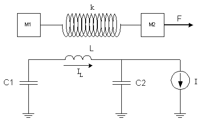

Sometimes, when analyzing physical systems, it's advantageous to consider using an analogous electrical model. The forms of the equations that govern mechanical and electrical systems are essentially identical, and the solutions to the resulting differential equations are thus also identical in form. Being able to bring the well-established methods of circuit analysis to bear on a mechanical problem can at times be a real boon.
In this problem one can use the established analogs (you can find tables of such analogs for various system types on the web if you persevere):
Mass <---> Capacitance; M --> C
Spring <---> Inductance; 1/k --> L
Current <---> Force; F --> I
In the present case the mechanical system and its electrical equivalent are straightforward:
Solve for the current through the inductor and you are essentially solving for the spring force as well. Laplace Transforms will take care of this problem in a few lines :wink:
