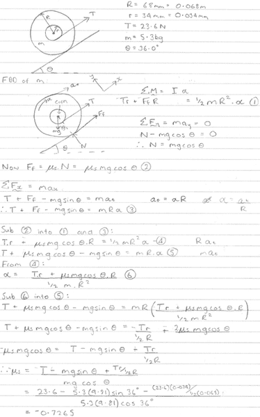

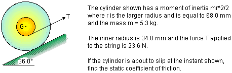

aolse9
23
[tex]\Sigma[/tex]M = I[tex]\alpha[/tex]
[tex]\Sigma[/tex]F = ma
I have made an attempt at this problem, it can be seen in the image below. I think I have done everything correctly, but my answer is incorrect. Any help would be greatly appreciated.
Any ideas?
...no ideas. Come on guys I'm running out of time!
