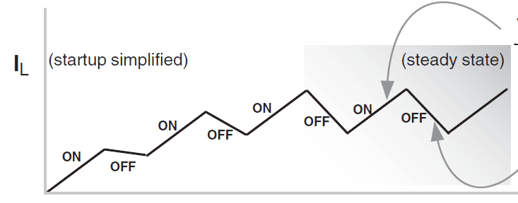

I am trying to understand the inductor current ramp up to steady state in a buck converter.
I don't understand why the inductor current slope is not steep in the beginning.
Let's say Vin=12v, Vo desired across the capacitor is 5V.
Switch turns ON, Inductor current ramps up. Switch goes OFF, Inductor current starts charging the capacitor for a time interval Δt. Now the cap is charged to say, 1v. In the next cycle, the inductor current has increased, it again charges the cap for Δt. Now the cap voltage goes to 2v. This goes on.
But I don't understand why the current slope becomes steeper.

What is the voltage at the input side of the inductor during the OFF portion of the cycle?
The slope of the OFF portion of the current waveform is determined by the voltage across the inductor during the OFF portion of the cycle...

Inductor voltage = voltage across the inductor
One side of the inductor is held at either 12v or -0.7v, the other side is the load voltage. Subtract the two to find the difference.

3 things to keep in mind:
1) You can not instantaneously change the current in an indutor. At the moment you "turn on" the inductor sees the full voltage and has 0 current.
2) There is always some other resistance / impedance - esp from the supply to the circuit, this is usually a critical limit.
3) Also the pulse width - should be much less than the time constant (over which you will see the effect of the inductor. If you look at the V and I for the inductor over time ( many on-off cycles / pulses) the curve will look more like an typical inductor curve. The model typically used within one pulse is a triangle - not a curve.
During the off portion - the current wants to stay the same - and decreases as the load absorbs the energy now stored in the inductor.
A capacitor is used to stabilize voltage ( by being an instantaneous current source) only makes sense here before the switch or after the inductor ( parallel with the load).
The trick is to realize that the VOLTAGE of the inductor can instantaneously change - so the instant the switch opens - it goes from absorbing energy to releasing energy - so what happens to the voltage across the inductor?? it should be clear - it reverses if there is any load current.
If the load is a capacitor - when the circuit reaches steady state the I goes to 0 ( cap is fully charged), then the diode is reverse biased and the cap just sits there charged.
When the circuit operates correctly, the capacitor voltage gets pumped up in steps, until it levels out at its final value.

The V ind after T on is coming to 0, not 12 V ( Assuming we are at steady state)
Here is a good reference : http://www.ti.com/lit/sg/sluw001d/sluw001d.pdf
Basic Buck and Boost converter voltages are relative to the duty cycle ( Ton:Toff)

At any time while switch is closed, for inductor voltage =12v the load voltage must =0.
If load voltage is not equal to 0, then inductor voltage cannot be 12v.
Okay okay. VL is 0 at the end of Ton.
But it's limited to (Vo+Vd) when the switch opens, right?

Probably not 0, but certainly heading that way. Dropping away.
Yes

That 60mA is probably an overestimate. You arrived at that value by applying 12v to the inductor and assuming that while the capacitor charges its voltage remains at (or close to) 0.
Ok, Initially the load voltage is 0v.
But then, max VL is (12-Vo)

Only at the initial moment is voltage across the inductor 12v; as the capacitor charges the voltage across L falls.
At the end of time ON time coil current reaches the value.
I _(0.5ms) = ( 12V * 500us) / 10mH = 0.6A So to output voltage will reach 3.6V
This is a very rough-and-ready estimation. Using your figures, the inductor voltage is only 8.4v towards the end of the ON period, so relying on 12v gives an overestimate.
Also, you are totally overlooking the fact that some of this inductor current powers the load (the 6Ω resistor) and does not add to the charge on the capacitor. So your figure of 3.6v is going to be way off, and for two reasons you have overlooked/forgotten/not mentioned.

Current in the inductor doesn't "drop", it smoothly ramps from one value to another. Apart from this, I don't think your figure of 0.18A is right.
