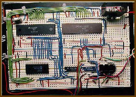

Most obvious trouble with breadboards like this
is wires come loose and flop against something so make DARN SURE there's no high(> about 15volts) voltage on your board.
Second trouble is as already mentioned, on a breadboard the leads will be longer. That causes trouble with noise pickup, every wire is an antenna.
Third trouble is , as mentioned, on a breadboard you can't "guard" sensitive inputs.
This TI datasheet explains that, see section CIRCUIT BOARD LAYOUT AND ASSEMBLY on page 8, and fig 4. http://www.ti.com/lit/gpn/ina116
Try it and see.
