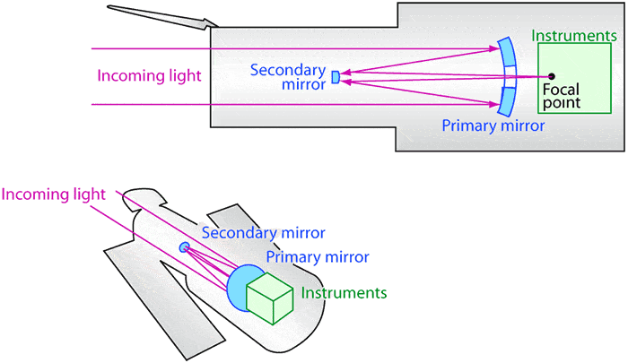

Take a look at the secondary mirror baffle on the Hubble telescope:
http://postimg.org/image/hlrst4rr1/2542d196/
Notice the small hole being the focal point:
Tell me again why having a small aperture like a pin hole would not be helpful at all? How would that effect resolution when mirrors are the devices collecting the optical information on a non-digital microscope?

That is not a pinhole. This is how pinhole optics work: http://en.wikipedia.org/wiki/Pinhole_camera

As that picture is drawn, the "pinhole" isn't doing anything for the focusing of the image; there's no light leaving the secondary that is being intercepted by the hole. As far as I can tell, it's there to allow the instrument package to be located behind the primary to maximize the uncovered and useful area of the primary. That has nothing to do with pinhole optics.
