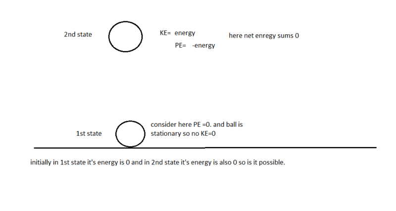

initially the ball is at the floor and have no kinetics energy see attachment that may help.It seems that here law of conservation energy giving wrong answer(single law can't define all the things). Is my explanation that it is limitation of Work Energy Theorem correct?
What you are saying is wrong. If the ball goes up its potential energy goes up (becomes positive), not down. Since kinetic energy is always non-negative, there is no kinetic energy that will make the total energy zero.
Just because two states have the same energy has nothing to do with whether the system will MOVE between the two states. A system moves along a path that minimizes its energy (essentially) at every instant. The two states you showed would NOT be connected by such a path so the system can't move between them. In order to give a ball that height work must be done on it, against gravity (as Halls_of_Ivy points out the change in potential energy from the ground can't be negative for this point). However, what you describe DOES describe a ball AT height 0 being dropped to the ground at (-h). In which case the motion does occur.
work to move ball from ground(h=0) to height h=x is -mg(x-0) (negative sign because force is in downward and motion is in upward). give it some kinetic energy so that total energy sums 0.Is it not now have 0 energy like initial position.
steger you say A system moves along a path that minimizes its energy (essentially) at every instant. I think you should add one more word that is potential energy. A system tries to have minimum potential energy(not kinetic).If i am wrong then tell me.
I like your point that two states have the same energy has nothing to do with whether the system will MOVE between the two states. Just before last reply i made i was thinking about it
You are quite correct, the potential energy is dependent on position where the kinetic energy is not (at least not directly). Therefore, minimizing potential energy will give you the particles route through space. What I was hinting at was something called the Principle of Least (or, more correctly, Extremal) Action, which is really the central core of all of physics from which pretty much everything can be derived.
