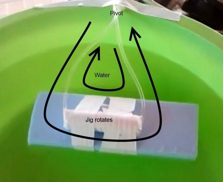

Experiment
I did a practical experiment to check the distribution of forces and I noticed the appearance of a predominant force which is the result of trajectory change of the fluid.
http://www.2live.ro/demo/Spira.bmp
https://www.youtube.com/watch?v=i0kb8dYL0lQ
Any feedback is appreciated, thank you.

If the fluid goes out at the same velocity as it comes in, there should be no net force on the pipe. But this is not the case in the video:
The fluid comes back where it came from, so it changes momentum. There is a reaction force on the float, which interacts with the elastic pipes, causing the swinging. Even if you make the net force zero, you still eventually have a net torque which will cause some movement. There is also possibly a "kick" when you switch the pump on, and the higher pressure straightens the pipes.

The coil causes a pressure drop so the inlet pressure will be higher than the outlet pressure. As pressure over an area relates to force there will be an imbalance. Also the friction will allow heat to dissipate along the coil and so an energy transfer happens there. The differential pressure within the pipes will be difficult to quantify as they will want to straighten under pressure, this force may corrupt your test results.
Also the coil you have drawn has a distinct separation from inlet to outlet but your test apperatus has the pipes close together, you may like to try the test with the pipes as drawn. Acceleration and de-acceleration will play a large part in your test as you start and stop the pump.
It is a rather elagant test but pipe straightening, P*A forces, heat dissipation and pressure loss make it tricky to deduce meaningful results. Not to mention the pipe shortening due to pressure increase, twisting of the coil as a result and gyroscopic effects causing motion.

Unfortunately, it still will not work. The fact that the entire system is not coplanar is irrelevant - if you were to analyze the forces on the fluid (and on the pipe) along the entire path, and integrate them to find the net force, it would still be zero. This is a case where your intuition is leading you astray - the same principle as applies in the simple case still applies here, but due to the increased complexity, it is no longer as obvious.

The principle is called Conservation of Momentum:
http://en.wikipedia.org/wiki/Momentum#Conservation
The net force on the pipe by the fluid equals the negated net momentum change of the fluid in the pipe.

No - actually, conservation of momentum works perfectly well in this case. All you need to do is look at the flow entering the pipe, and the flow exiting the pipe. In this case, the flow entering the pipe is going upwards, but the exit flow is downwards. Thus, by conservation of momentum, there must be a net upwards force on the pipe to counter the downwards force on the fluid. However, this all changes when you bend the above system:
http://www.2live.ro/demo/arc_open.bmp
Now, the incoming flow (I'll assume the inlet is on the left) is traveling to the left. The outcoming flow is also traveling to the left. Assuming the pipe is constant diameter, and the fluid is incompressible, the flow speed is the same at the inlet and outlet. Therefore, since the flow speed and direction are identical at both the inlet and the outlet, there is no net momentum change in the fluid, so there is no force on the pipe.
I think you're confusing yourself with the spiral pipe. It's true that in the first image above, the net force can be considered to be entirely from the U-shaped section, and the forces in the spirals all cancel out. However, this is no longer the case when you bend the spirals. The force nearly cancels out in the spirals when they are bent (so long as the bend radius is large relative to the spiral radius), but it doesn't entirely cancel out, and if you felt inclined to do the vector sum along the entire path, you would discover that the slight imbalance in the spiral is exactly enough to counteract the force in the U-shaped section. That method is absolutely valid, it simply isn't used very frequently since conservation of momentum allows us to arrive at the same result with much less effort (and it allows us to bypass errors of intuition more easily).
