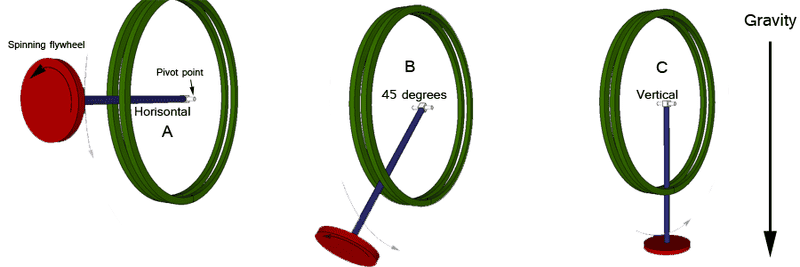

I have drawn an illustration in Google ScetchUp - hope you understand it.
It is a fast spinning flywheel (red) on a shaft (Blue). Two green guides prevents the shaft and the flywheel to move sideways.
Gravity is pulling on the heavy flywheel.
Question:
As the spinning flywheel starts falling from the top (Not illustrated). Will the velovity of it be greatest at point A, B or C?
What velocity can we expect at point A, B and C?
Will the shaft with its spinning flywheel behave as longer pendulum (Kind of a pendulum in slow motion)?
Vidar

Ofcourse, velocity cannot be known with unknown RPM of the flywheel, its weight, and length of the shaft. Forget that question.
Anyone?
Vidar
  • #34
That is a really annoying system to analyze. The weight will cause a torque about a horizontal axis which will try to get the gyroscope to precess horizontally. It will then run into the green guide which will exert a force to prevent its horizontal precession. This force will also generate a torque, this time about the vertical axis. The torque about the vertical axis will cause the gyroscope to precess either up or down until it reaches the top or the bottom. At that point gravity will no longer be exerting a torque and it will just stay there. It will not act as a pendulum.
  • #35

Very annoying actually. At risk of getting a lot of lag error, I venture to ask some questions, and write down some thoughts:
What is the reason why the weight will move upwards? One would think at first glance that the vertical torque is solely caused by the weight and gravity.
Wether the precess wants to be clockwise or counterclockwise perpendicular to the guides wouldn't matter as there is no physical precess present due to the guides, right?
If horizontal precess really is an important factor of which vertical direction the weight will move in this system, I will accept that - but have trouble in understanding why.
In my mind, the spinning itself will cause increased "inertia" that is parallell with the force which pulls on it. However, I might not use the word inertia, but I couldn't find a better word.
As this system will not act as a pendulum but stop at the bottom or the top, the weight will slowly move down or up, and rest there so the weight is spinning perpendicular to the force of gravity.
