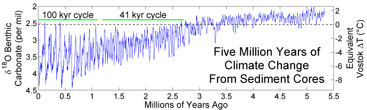

How does this post relate to the 100-kyr eccentricity cycle? After reading 'The Two Mile Time Machine' by Richard Alley, I was left with the impression that the insolation difference of a varying Earth-Sun distance of around 6% was not enough to explain the cycle of the ice ages. Can someone please enlighten me if I'm simply being stupid.

Hopefully, I can figure out how to include attachments here.
About 2.5 million years ago periodic ice ages began.
Originally, the warm periods were on 41,000 year cycles.
Over time, the warm periods degraded to 100,000 year cycles.
The Earth's orbit basically has 20,000, 41,000 and 100,000 year cyles to it.
There is not much difference between the 41,000 and 100,000 year cycles.
So, it has been a struggle to figure out why the Earth did the transition.
The latest that I've heard is that CO2 levels were just getting too low and the Earth appeared to be gradually slipping into a permanent ice age.
Here's a useful image and an good science article.
  • Integraded Solar Irradiance.pdf

The Huybers paper explains that glaciers/ice caps are sensitive to insolation integrated over the duration of the summer. And integrated summer insolation is primarily controlled by obliquity and not precession, which is on a 40K yr cycle.
However, as the Earth cooled during the Pleistocene, the 40K cycle heat eventually wasn't always enough to triger glacial termination.
Sometimes it wasn't until the 2nd or 3rd cylces that the glacial sheets would be sufficiently melted. 80K and 120K averaged out to 100K.
So, there really is no pure 100K cycle. It just happens to be the average value over the last million years of 2 or 3 40K cycles.

Xnn said:
Mammo;
This is an interesting summary of the situation: http://www.moraymo.us/current_projects.php . The change from a 41,000 to 100,000 cycle appears to be quite abrupt. What is the mechanism for an abrupt permanent decrease in global CO2 levels?
