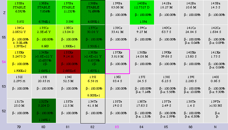

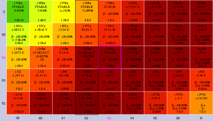

Since I'm in a confessional mood, I guess I should also admit I don't really understand how the various isotopes of cesium are produced: is it correct to say that Cesium 135 is the decay/daughter product of Xe135 (which itself is a fission product of U235), and that Cesium 137 and 134 are the direct fission products of U235?
Concerning Cs-134, -135, -137, refer to the attached images.
Note the darker squares in the first image, which provides the fission yields for each radionuclide. The yield for Cs-134 and Xe-134 is rather low. The main source of Cs-134 is the precursor Te-134 (fis yield ~ 0.0622) with a trace from I-134. The successive chain is Te > I > Xe > Cs. Similar Cs-135 comes from decay of Te-135 and I-135. On the other hand, Cs-137 comes primarily from the decay of Xe-137 and I-137 (with yields of 0.0319 and 0.0262, respectively). These isotopes can also be produced by n-capture of their A-1 neighbors.
The second image shows the n-capture cross-sections for (n,γ) reaction. The third image shows the half-lives of the radionuclides. The half-life of Cs-135 is approximately 2.3 E6 years, which means is has a very low activity. Also note that Xe-135 has a high n-capture cross-section, and much of that is transmuted to Xe-136.
