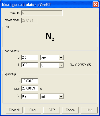

Well, as I said, assuming that the given pressure is absolute pressure, I calculated about 298 grams for the mass.
I notice that the value for the volume is given to only one significant figure. Perhaps the answer needs to be specified with a corresponding accuracy: 300 grams.

298 g no matter how you try. Even assuming 3.5 atm (2.5 + 1) or 300 K (possible typo) neither of the answers given fits.
