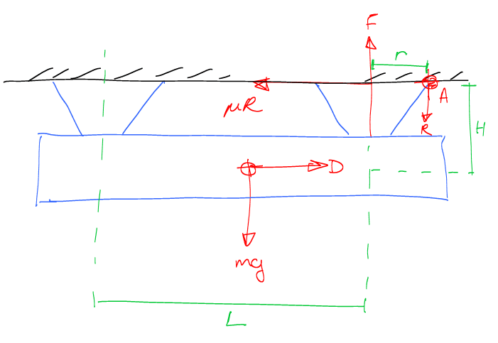

Hello. I am trying to calculate the minimum vacuum force required to keep a climbing robot attached to a ceiling. The robot body consists of a cuboid with two vacuum cups attached at either end. The robot will move using inchworm-style motion, attaching one of the cups, extending its body, attaching the second cup, retracting etc. In order to calculate the minimum vacuum force that the robot needs to generate, I have constructed the following free body diagram:
To calculate the maximum force, I am consider the situation where the robot has only one of its suction cups active, which in this case is the one on the right.
Description of forces:
- F: The suction force produced by the vacuum cup.
- R: The reaction force produced due to the robot pressing against the ceiling
- uR: Force due to friction between the ceiling and the robot's suction cup
- D: Drag force caused by fluid moving past the robot. This is 1N
- mg: Weight of the robot. This is 0.2*9.81=1.962
List of dimensions:
- r: Radius of the suction cup. 15mm
- H: Distance between the C.o.M of the robot and the ceiling: 17.5mm
- L: Distance between the suction cup centres. 56mm
In order to perform the calculation, I have made the following assumptions:
I have assumed that as the suction force decreases, the robot will not just simply fall vertically, but will behave almost as if it was hinged at point A in the diagram. Based on this assumption, I have assumed that the only reaction force is the one shown on the diagram. This is because if the suction force is at its minimum, I would imagine that the inactive suction cup would be barely touching the ceiling and so no reaction forces would be generated. Likewise, I am guessing that the side of the left hand side of the active suction cup would also be barely touching, leaving the very right hand side in firm contact with the ceiling.

Resolving vertically:
[tex]F = R + mg[/tex]
Resolving horizontally:
[tex]D = uR[/tex]
Taking moments about A:
[tex]Fr = DH + mg(\frac{L}{2} + r)[/tex]
Solving the above equation gives a value of [tex]F = 6.79N[/tex]
Substituting this value back into the first equation gives a value of [tex]R = 4.83N[/tex]
Finally, inserting this value into the second equation gives a value of [tex]u = 0.2[/tex]

What I am unsure about is whether this is the correct way of calculating the minimum force. I am especially unsure about the assumption I have made regarding the reaction force. Should there be reaction forces on both suction cups? Should I consider those forces as one force for each cup, or would I need to consider the reaction forces on both sides of each cup? Am I correct in assuming that the robot would rotate around point A as the suction force decreases? Would I then need to consider any friction produced at the inactive suction cup?
