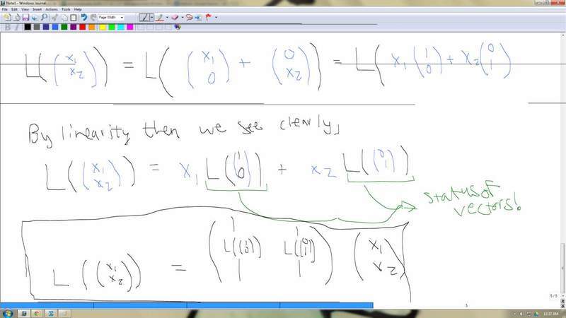

I do not know what the term matrix means to you, but in brief and for our purposes, a matrix is simply a "linear transformation" which when acting on a vector gives out another vector! The size and shape of the matrix tells you the quality of vectors it takes in and those which it spits out (e.g. a 3x2 matrix takes in 2-D vectors and spits out 3-D vectors). The components of the matrix are to be inferred as the exact processes that alter the input vector so.
This transformation is linear for the reason that when it acts on a sum of vectors, it may superimpose their individual results together, and when acting on a multiple of a vector, is equivalent to acting on the vector and stretching by the same constant.
Somehow we have to exhibit some mechanism, some matrix which when acting on our 2-D vector, with components x1 and x2, gives out a 3-D vector of the specified shape.
This is best done as follows:
Note in the last step I abused the following fact (one that is to be well understood)- a column vector which when applied by a matrix, reproduces another column vector that takes a linear combination of the columns of the matrix.
Likes 1 person
While the above technique is the most promising, as it makes reference to no other special theorem by itself, an alternative popular approach is as follows:
ask yourself what does this transformation do on the vector (1,0)?
what does it do to the other basis vector (0,1)?
These form the columns of the transformation matrix! The reason why has intimately to do with the priori the transformation is linear!
