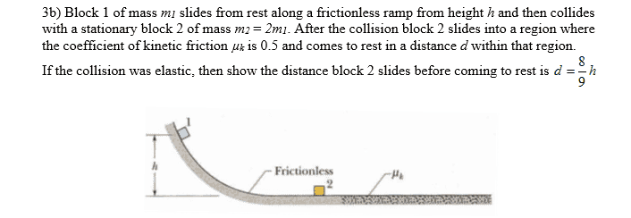

Stopping distance after a collision down a ramp

Ep = Ek
mgh = Ek
mgh = ½mv²
v = √2gh
As the collision is elastic, m1u1 + m2u2 = m1v1 + m2v2. It is known that m2 = 2m1.
m√2gh = 2m1v2
v2 = (m√2gh)/2m
v2 = (√2gh)/2
Force body diagram of m2:
̂̂̂̂̂̂Fnet = ma
Fnet = Fn + Fg + Ff
Fnet = Ff
m2a = Ff
a = Ff/m2
a = Ff/2m1
a = uN/2m1
a = 0.5*m2g/2m1
a = m1g/2m1
a = g/2 (negative)
v^2=u^2+2ax
0= v2^2 - gx
gx = v2^2
x = (v2^2)/g
x = 2h/9
The answer is 8/9h. My solution differs from the lecturers at this point:
I do not understand what he was done
I would not use forces, body diagrams or accelerations. I would use just momentum and energy conservation:
1. compute v of m1 at bottom just before collision
2. equate momenta of m1 and m2 just before and just after collision
3. express energy conservation just before & just after collision for m1 and m2
4. equate k.e. of m2 just before entering the rough patch with the energy dissipated by friction.
4 equations, 4 unknowns: velocity of m1 just before & just after collision, velocity of m2 just after collision, and d.I would not use forces and accelerations. It's easier to use energies.
