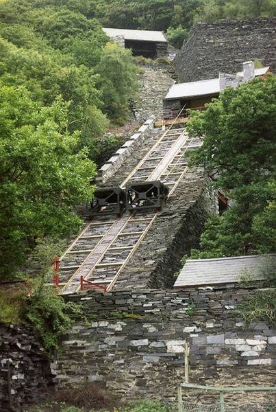

I'm imagining something like this, with doors for the loading and unloading mechanism that are "self-powered."
There are the remains of a 150-year-old rail line near where I live, which had ten cable-operated inclines powered by stationary steam engines in a distance of 30 miles, with the steepest gradients about 1 in 8. The "road" down this hill (continuing along the right hand side of the water reservoir in the distance) used to be a part of the track.
Yes, it is exactly the same idea alephzero pictured. The cycle is 120 times/day. So, 5 min charging and 7 minutes down time. The idea is to not have an operator near the cart when the doors open and unload.
