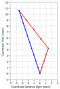

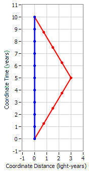

Perhaps some spacetime diagrams for a concrete example will help to make it clear. I will use the example of the space twin traveling away from the Earth twin at 60% of the speed of light for four of his years and then turning around and coming back to the Earth twin at the same speed, as defined by the rest frame of the Earth twin. The Earth twin is depicted in blue and the space twin in red. The dots mark off one-year increments of time. If the dots correspond to the Coordinate Time, then there is no Time Dilation. If the dots are stretched out farther than the Coordinate Time, then there is Time Dilation. Here is the diagram for the Earth's rest frame:
As you can see, the Earth twin has aged 10 years and the space twin has aged 8 years (count the dots, starting from zero).

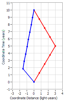

Now we can transform the coordinates of all the events (dots) in the above diagram to an IRF that is traveling at 60%c with respect to the first IRF. This will make the space twin stationary for the first half of his "trip" (which is not really a trip yet since he starts out stationary in this IRF):
This is the situation where the space twin has to travel at faster than 60%c to catch up to the Earth twin.
Please understand that both of these diagrams depict the exact same scenario, we have just looked at it from two different IRF's which change the Time Dilations during the three straight line segments (one in blue, two in red) but the aging of each twin remains the same (10 for blue, 8 for red). Note that blue ages by the same amount during the entire scenario but red ages faster at the beginning while he is at rest and slower while he is traveling to catch up.

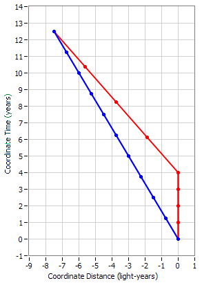

Now I'll show you the IRF in which the space twin is at rest during the last half of his "trip":
Now the space twin is not catching up, but rather slowing down to a stop in order to let the Earth twin catch up to him.

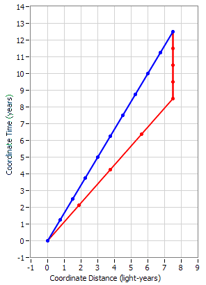

Next, I want to show you another IRF, just to make sure you don't have the idea that the only valid IRF's are those in which an observer is at rest. In this IRF, we start with both twins traveling in opposite directions at the same speed and then the space twin turns around to catch up to the Earth twin:
Note that both twins are Time Dilated by the same amount at the beginning of the scenario and then the space twin ends up Time Dilated even more so that their ages are the same as in the other IRF's.

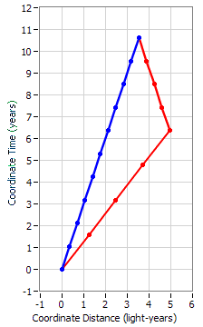

And we can do another IRF in which the twins start out traveling away from each other with the space twin going faster but then when he turns around, they approach at the same speed:
Can you see how in each of these IRF's, the speeds of the two twins are different and so the Time Dilations are different but when you add up the amount of aging for each of them, they end up the same?

For the simple case where one twin remains inertial (doesn't accelerate) and the other twin does accelerate, then you can make statements like this but I don't think it is useful to think that way because there are other scenarios where both twins accelerate and for which the statement it is not true that the one that traveled at some point at a greater velocity is the one that ends up younger.
For example, here is a scenario where one twin starts off traveling in one direction at 80%c for a year and then returns at a slower speed while the other twin travels all the time at 60%c:
The first twin ages 9 years while the other one ages 8 years. So it is not true in general that you can just identify the younger twin simply by noting which twin traveled faster. And remember that speed is relative to the IRF so you can change which twin travels faster (in some scenarios) simply by transforming to a different IRF. Shortcuts and "rules of thumb" tend to be dangerous in SR. Better to just work out the details of any scenario (using any IRF you want) to see what happens.
