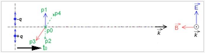

This is from Wikipedia:
http://en.wikipedia.org/wiki/Em_wave
The electromagnetic waves that compose electromagnetic radiation can be imagined as a self-propagating transverse oscillating wave of electric and magnetic fields.
1. What is really meant by "self-propagating", how it works?
2. How many electric and magnetic fields are in one wave?
3. What is the strength of those electric and magnetic fields?
4. What does -q and +q represent in the above diagram?
5. Why would electric and magnetic fields oscillate?
1. By self propagating it means that the change of the electric field generates a magnetic field which is changing itself. The change of the magnetic field generate an electric field and so on.
2. The field is something that is extended all over space. There is one electromagnetic field, and it is oscillating.
3. What do you mean by "strenght"? If you are talking about the amplitudes of the electric and magnetic fields, they are not fixed. They depend on each particular case. However, the are related as B=E/c.
4. Two oscillating charge.
5. Because the two charges oscillate.

The two charges are oscillating in response to the EM wave, they are not causing the EM wave.
To elaborate on a few of the questions:
1. Self propagating means that once the wave has been created, it continues to move outwards from the source without requiring anything to act on it.
2. An EM wave is a wave within the EM field. As Einj mentioned already, there is only one field. The part of the field that is "waving" is the field vectors, which is what we use to determine how an electric charge will respond to an electric field. When the vector (the lines in the wave above) points up, a positively charged particle will be accelerated up, while a negatively charged particle will accelerate down. When the vector points down the charges will reverse their direction of acceleration. This is why antennas work. The EM waves cause the charges in the antenna to oscillate back and forth, which is detected with the electronics and amplified for processing.
4. The +q and -q represent a positive lyand negatively charged particle respectively. They are there to show you how an electric charge responds to the wave.
5. The vectors of each field oscillate in response to an accelerated charge(s) that creates the wave. The details of why this occurs would require study of electromagnetism and involve some math.

So the electric field has its strongest negative polarity magnitude at the top amplitude points, strongest positive polarity magnitude at the bottom amplitude points, and zero magnitude where the blue line crosses k vector? Basically it goes ON and OFF while switching polarity from positive to negative?
They represent receiver antenna rather than emitter, even though they are on the left side of the diagram away from the direction of propagation?
No, I understand that to mean that that is how a positive and a negative point charge will respond to a passing EM wave
Electric fields and magnetic fields follow Maxwell's equations and the Lorentz force law:
http://en.wikipedia.org/wiki/Maxwell's_equations#Conventional_formulation_in_SI_units
http://en.wikipedia.org/wiki/Lorentz_force#Continuous_charge_distribution
Those laws admit a wave solution:
http://en.wikipedia.org/wiki/Maxwel...s.2C_electromagnetic_waves_and_speed_of_light
One thing that characterizes waves is that they "self-propagate". I.e. a wave here now propagates into a wave there later.
You don't count fields. They are not discrete.
That is related to the intensity of the wave. In the visible range of the EM spectrum a stronger EM field corresponds to a brighter light.
Charges, presumably from a dipole antenna.
Because they follow Maxwell's equations and Maxwell's equations admit a wave solution. See the response to 1.
Actually at the beginning they are what causes the oscillation of the field. This is how antennas work. But your are probably right, after the field starts oscillating their motion is sustained by the field itself.
Of course, you are right. An electromagnetic wave (e.g., light or radio waves) must be created by acceleration of charges (in the classical picture, to which I'd like to stick for a while in this thread).
The sources (and the only sources) of the electromagnetic fields are charge and current distributions. If these are time dependent (and not just the Lorentz boost of a static charge distribution to another inertial frame, where they move with a constant velocity) electromagnetic radiation is produced.
These fields are dynamically propagating not only within matter containing charged particles but also in free space. That's what Wikipedia might mean by "self propelling". It's a bad wording, however, because there is nothing "self propelling" here. It's just like a ball you through, and it's moving further without being in contact with you anymore. In free space, i.e., without gravity and air friction, according to Newton's Laws it would just go ahead in uniform motion. It's not self-propelled. In a similar way also the free em. field travels on in free space and is not self-propelled.
It is also a wrong picture you get when it's said that the changing electric field causes a magnetic field and vice versa. You cannot interpret the corresponding homogeneous Maxwell equations (i.e., Faraday's Law and the Ampere-Maxwell Law) in a causal sense. There is only one electromagnetic field. It's even an observer dependent statement what you call "electric" or "magnetic" fields. The electromagnetic field as a whole is a frame-independent concept (described by an antisymmetric 2nd-rank tensor in Minkowski space, called the Faraday tensor).
The "strength of the field" in a certain sense can be associated with it's energy density, which is given (in Heaviside-Lorentz units) by
[tex]\epsilon=\frac{1}{2}(\vec{E}^2+\vec{B}^2).[/tex]
It depends on how vigorously you wiggle the charges, labeled with [itex]\pm q[/itex] in the figure, which is, however, very misleading, if not entirely wrong. What seems to be depicted is the most simple example of a radiation source, the Hertzian dipole (which is realized approximately by, e.g., a linear antenna with a harmonic current; it becomes exact in the limit of vanishing length of such an antenna). The field looks entirely different from the plane wave plotted in the picture. A much better picture (even animated) can be found here:
http://en.wikipedia.org/wiki/Dipole_radiation#Dipole_radiation
The 5th question cannot be answered other than by "that's how nature is". The Maxwell equations which describe electromagnetic phenomena to high accuracy (as long as quantum effects can be neglected) are fundamental laws which have been found after some centuries of observations and just summarize in an elegant mathematical model these observations. They canno be derived from simpler principles and are fundamental in that sense. The existence of electromagnetic wave fields has been in fact predicted by Maxwell and have been found later in experiment by H. Hertz. This is a typical example for the way how science works: You start from a lot of observations, doing quantitative measurements and then find a fundamental law (which is a very rare event, by the way) which leads to further predictions about phenomena that may never have been observed before (or as in the case of electromagnetic radiation have not been realized as such; nowadays we know that visible light is nothing else the electromagnetic radiation in a specific range of wave lengths our eyes are sensitive to). Then you can try to do new experiments to check, whether electromagnetic waves really exist. If not, you have to modify your mathematical model or create a completely new one. If you find them, as is the case here, you have consolidated the validity of the model, and so on.
The reason or explanation for wave propagation is that it takes time (a delay) for an effect, in one place to reach another place. As you change the positions of the two charges (as they oscillate together and apart, for instance) and plot how the effect varies as you get further away, you will get a snapshot of the way oscillation varies in time, and that reveals itself as a 'graph' over the distance. The wavy graph will be moving away from the source at the speed (wave speed) that the effect can travel through the medium (space / air etc)
This is the same for EM and mechanical waves - it's just the mechanism that's different. The overall effect is that energy gets carried away from the source by the waves.

So is electric field in EM wave negative or positive, or both negative and positive in the same time, or little bit negative and then a little bit positive?
Maxwell didn't just accidentally find a fundamental law or blindly attempt to formulate the wave equation. It is interesting then his theory was discarded while the equations were kept. It's like developing a theory to make pudding just to end up with the recipe for making a perfect sausage. Mmmm.

Here I isolated a single point at time t0 and five points of interest marked from p0 to p4. Is electric field stronger at point p0 or p1? Is electric field at point p1 positive or negative? Compared to p1, what magnitude and polarity is the electric filed at point p2, p3, and p4? Same questions for the magnetic field.
  • #32
What are the initial conditions? At which time are you looking at the various points? How are the charges moving? Without this input, nobody can calculate what you want to know. Please look up the Wiki page on electric-dipole radiation which gives you a pretty good overview over the field created by such a dipole if the time dependence is harmonic and the wiggling of the charges started a very long time ago. As I already said the plane-wave picture is wrong (or only valid approximately very far away from the dipole).
The italics text in #29 is utter nonsense, as I've already explained earlier in this thread too. The correct equations to look at are Jefimenko's retarded solutions of the Maxwell equations for a given charge-current distribution. A time varying electric field cannot be straight-forwardly interpreted as the source of a magnetic (vortex) field and vice versa. This idea is simply a misinterpretation of Maxwell's equations that are local in space and time.
  • #33
I'm not setting up conditions or deciding how charges are moving, just trying to interpret the diagram. I'm looking at any instant in time where blue vectors are depicted as vertical arrows pointing upwards.
I'm not asking for any numerical values now, only about general properties and basic relations: greater, less or equal, positive or negative.
It doesn't make sense to me either. As I remember Ampere's and Faraday's law it's moving E field that creates B field, not changing, just moving, and moving E fields are electric current. So basically it's electric currents that create B field depending on current density. In return changing magnetic field can create an electric current by making E fields move, but I never thought B field can change E field or create new ones.

Not enough if there can be misinterpretations like vanhees71 is talking about. Maxwell himself had a whole different idea about what those equations mean and represent. Apparently they can mean different things and be interpreted in different ways, unfortunately.
  • #35
pleco said:
There are fields lines and then there are force lines. Electric field lines coincide with force lines, but magnetic field lines and force lines are perpendicular. The question is only what kind of lines those vectors in the diagram represent, where are they measured at and what are they relative to.
The vectors in the diagram are field lines.
The electric field is only shown at p0. The end of the vector is not a point in space, it is just a representation of the strength and direction of the E field at p0. This is a fairly standard method of representing vector fields.
http://mathinsight.org/vector_field_overview
Regarding the polarity, that depends on the direction of the coordinate axes, which are not explicitly shown. If right is x, up is y, and out of the screen is z, then the E and B at p0 are both positive.
