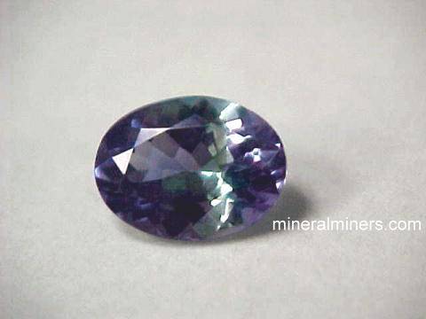

I have some untreated Tanzanite rough that I'll facet someday. It is trichroic, and ought to have some interesting colors based on the light-path through the cut stones.
Like this:?
This website seems to indicate heating the stones removes the trichroism (?)... do you know the cause of the phenomenon? What's the crystal structure of Tanzanite?
http://www.moregems.com/pages.php?pageid=30
I don't know the physical properties that cause the color-change. My rough stones were bought from a friend who often went to Africa to buy gem rough. Depending on orientation, my Tanzanite can look purple, blue, or reddish-orange. I had bought heat-treated rough from him before, and when he offered non-treated rough at a significant discount, I bought some, figuring I'd play with cut-pattern, orientation, etc and see what comes out. If the stones end up looking crappy, I could always get a knife-making friend with a muffle furnace to treat the stones after the fact.
