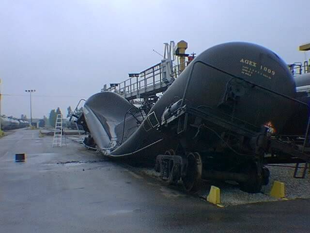

A condenser in a power plant is made pretty robustly in order to withstand the "vacuum".
Lsos said:
So, if you take a 1600 liter jug filled with steam and try to condense it back into liquid...
...some equilibrium will be reached where the pressure in much less than atmospheric.
Multiply that that jug into a tank car.
What exactly happened there DrClapeyron?
