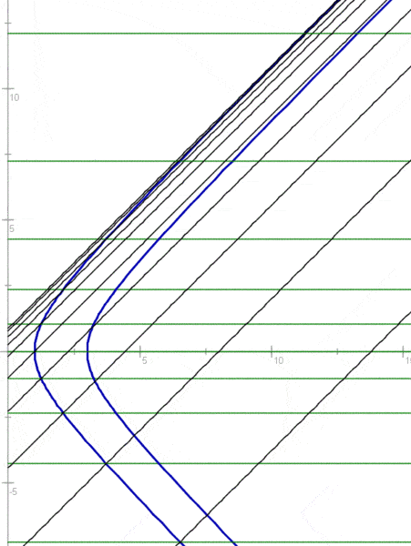

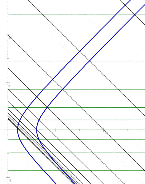

I have had a closer look and it looks like I was a bit hasty and you (and stevendaryl) are right. The rear observer does observe blue shift from signals coming from the leading rocket, even if there is no length contraction. This can be seen from examining the attached graph "f2b" which plots the paths (blue) of two rockets with equal and constant proper acceleration as seen in an inertial reference frame. The horizontal green lines are lines of equal proper time on the accelerating rockets at one unit time intervals. On this graph the diagonal black lines are signals sent from the front rocket to the rear rocket at regular unit time intervals. One interesting aspect is the the blue shift seen by the rear rocket reduces asymptotically towards unity as time progresses and the proper separation of the rockets increases.
Austin0 said:
It would seem to also apply in the other direction with the exception that in that case the difference in time dilation would cancel out part of the red shift due to the increased velocity
It also seems like there would be more red shift due to velocity measured in the front ship than blue shift due purely to velocity measured in the rear ship.
With the dilation factor working oppositely I guess it would take calculations for specific conditions to determine what the relationship would be.
Perhaps

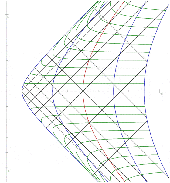

This is correct too. The leading rocket does observe red shift of signals coming from the rear rocket with or without length contraction. The attached chart "b2f" charts the no length contraction case where the rear rocket sends signals at regular unit time intervals to the front rocket. Again there is an interesting aspect, in that the red shift increases dramatically over time, which is the exact opposite of how the blue shift seen by the rear rocket evolves.
The final attached chart is the length contraction case which is associated with the Rindler Metric and Born Rigid acceleration. In this case the distance between rockets and the blue or red shift from neighbouring rockets, remains constant over time, in an accelerating rocket reference frame. The green curves are the "lines of equal proper time" for the rocket and plotted at 1/2 unit time intervals. For those that might be interested, these curves are plotted using these parametric equations:
[tex]x = r * \cosh (T/r) [/tex]
[tex]t = r * sinh(T/r) [/tex]
where r is the parametric variable and T is a constant (The proper time). r is also the nominal radius and is inversely proportional to the constant proper acceleration of a given rocket.

  • #31
Austin0 said:
Hi Take a look at yuiop's diagrams a couple of posts back. Compare the relative path lengths between forward and backward travel and see if you still think the front to back travel would have greater effect on elapsed time than the travel from back to front.
I have no idea what the diagrams mean.
I think we can say this:
In all cases when the clock did make extra ticks, because of the visit it made upstairs, in these cases the bacward travel had greater effect on elapsed time.
