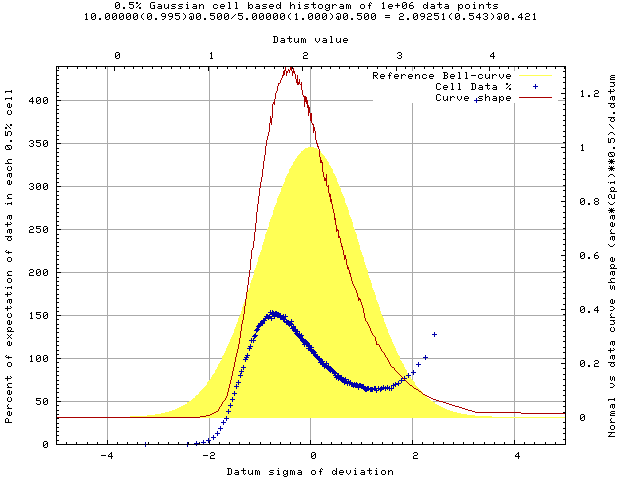

Hi,
When using data in calculations, errors can be introduced by the calculations themselves;
A common example of this kind of data is the atomic mass of some element; The data might be reported by NIST as: 190.233(20), which indicates that the mean is 190.233, and the maximum likelihood deviation is 0.020. Data from NIST is always assumed to be GAUSSIAN.

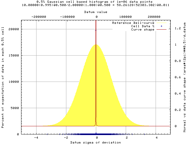

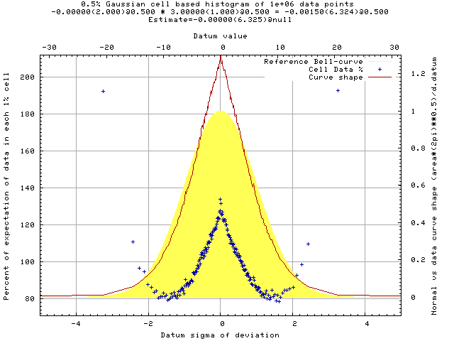

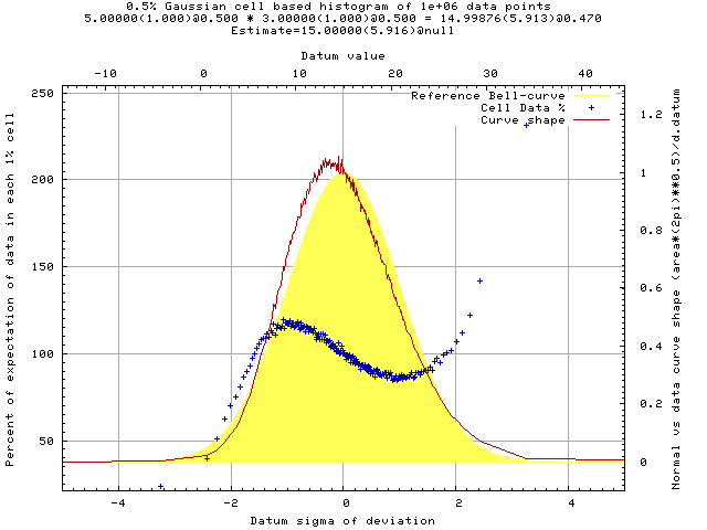

But doing operations on Gaussians (eg: ×,/ ) can produce resulting distributions that are not Gaussians:
png 1, example multiply
png 2, example multiply
Generally, people ignore this problem and just assume the result *is* still a Gaussian (not to mention that people typically don't use the exact formula for getting the sigma and mu of multiplication) Hence the error can compound rapidly as more operations are performed.
I'd like to do something a little better (but not much.), I'd like to create a single composite PDF/CDF that replaces the Gaussian and corrects somewhat for these introduced errors.
It is NOT practical to compute the exact CDF/PDF for a series of operations, but only for one or two. Hence, I want to design a single CDF/PDF (call it O) that can "optimize" the error.
Each operation's result would be measured (somehow) to produce the best fit parameters for a near-equivalent "O" distribution.
I am planning to keep only mu, sigma, skew, and possibly kurtosis at each step as definitive of a unique "O"

With regard to division, you are going to get some crazy stuff for dividing two random variables if a zero (or that neighbourhood) is involved regardless of a zero mean: as long as you get significant probability in the region.
If you want to figure out the PDF given say X divided by Z there are a couple ways of doing this (and this will help you analyze your errors accumulate with regards to the number of variables you use).

andrewr,
I didn't find the phrase "maximum liklihood deviation" in that link. When speaking of "standard deviation" or "probable error", it will be clearer to mathematicians if you use the term "standard deviation". (From a mathematical point of view, that NIST handbook is terrible. Even for a government document, it has a many wordy pages that have no significant content.)
As Chiro points says, the distribution of X/Y fails to have a mean or variance when X and Y are independent Gaussian random variables even in the case when the mean of Y is not zero. So you don't have any hope of finding these. To deal with X/Y you need a more realistic model of how experimental measurements are made. Perhaps it should reflect the fact that people discard measurements that appear absurd or that real lab instruments can only output a finite range of values.
Yes, I wish I had said it better. I noticed that after I wrote it, but didn't have time to edit.
Sometimes it's just Easier to take the punishment... Sorry if you wasted some time, Chiro! But I am interested in how you approached the issue, and will spend time working through your comment. :smile:
Yes, and in multiplication too...as already plotted :smile:
See uncorrelated division plots attached. Most of divison's craziness is the same as for multiplication; Division is more extreme, but it behaves much in the same way. The divide by zero issues, typically don't happen even though they could. If in a sample of a million, the curve is still well defined even with zero at a significant percentage location -- the result is not unreasonable to use; Most people physically doing such an experiment wouldn't ever notice it either...!

One of the other objectives in the original post is to solve a similar problem for the quotient X/Y of independent Gaussian random variables and we have agreed that mean and standard deviation of the distribution of X/Y may not exist. However, you feel it is still possible to make progress - which necessarily means that we must solve some different problem. I gather that you think we might modify the problem by "leaving out" the event that Y is exactly zero. My intuition is that this won't work. I think you'd have to leave out a finite interval around the value Y = 0.
Hmm, well -- in the plot I showed, where zero was included -- the numerical simulation never hit zero in over a million trials. ( I doubt NIST even attempts that many actual measurements to produce a single result! ) My Graph still had a well defined shape and although one might question the precision of the sigma value, it has a very real robust virtue: It is so large as to be easily identified by eye as an unreliable result. This happens to be very uniformly true in problems where zero becomes a realistic value in the division...
If the calculation (which is designed/chosen by an Engineer/Chemist) is intrinsically un-reliable, it becomes NOTICABLE.
OTOH: There are many *practical* division problems with Gaussians (esp; where |mu| > sigma > 0 ), that are going to produce *very* reliable results (small sigma). Both of these cases are a very useful thing to an Engineer/Chemist since KNOWING how badly a particular division affects the sigma gives them some additional (and intrinsic) cross checking of their model.
As I mentioned before, if you want to solve the problems in a way that relates to actual physical measurements, you shouldn't use Gaussian distributions.
That's laudable, but I don't really see that I have a choice in the real world.
The calculations are going to be done with the assumption of Gaussians, the question is merely -- how often will inaccuracies introduced by the calculations give statistically false positive results?
Let me try and give a little perspective;
When doing an error propagation analysis for something which contains multiplication OR division, esp at the undergraduate level, and even much of the masters level, there is a cookbook approach used by a large portion of problem solvers:
http://en.wikipedia.org/wiki/Propagation_of_uncertainty
(! And NOTE: Viraltux has been correcting this page, which is GOOD ! )
Now, I believe these formulas are *VERY* mainstream, and show up even on mathematical oriented sites.
BUT: Notice, that for both multiplication and division, the formula is using a ratio of the error (std dev), to the mean. For multiplication, this is fine -- for, as I derived elsewhere -- the product of the means happens to be the mean of the products for independent variables.
(And I ought to have just remembered that from basic stats...but oh well, I proved what I ought to have known...)
However, when I try that for division -- by simulation -- (see graphs above!) -- the same can't be said! In practical terms, this ratio approach causes major defects in the robustness of the approximations:
eg: If I were to, for example, want to multiply a value of 0(1), times 17(0), I know the result is very predictable by numerical simulation -- (It's a true Gaussian EVEN!) but the mainstream multiplication approximation will fail, because computing the result requires a division by a zero...
And, Division approximations are *apparently* even worse...
(I have simulations, not analytical expressions so I don't wish to over-state the case.)

We should get the facts about the ratio of two Gaussians straight. The Wikipedia has an interesting article which reveals some of them. http://en.wikipedia.org/wiki/Ratio_distribution
In the case of the ratio of two independent Gaussians X and Y , each with mean zero, the distribution of X/Y is a Cauchy distribuiton whose mean and variance do not exist. http://en.wikipedia.org/wiki/Cauchy_distribution
There may be some hope in the case where mean of Y is not zero, but I haven't found any overt statement of the facts. The paper by Marsaglia "Ratios Of Normal Variables" (PDF: http://www.google.com/url?sa=t&rct=...sg=AFQjCNEgO1dvktreWiL-rt-ZPcS3K1FmYQ&cad=rja) may contain the answer if you can decipher what happens in the special case when the two "jointly normal" variables he deals with are independent. In his general case, the mean and variance apparently don't exist. However, he has suggestions for practical applications that involve assuming bounds on the denominator (i.e. truncating it !).
Yes, and that's the Cauchy 0/0. Which I mentioned before as being a serious problem. But, Considering even that distribution *is* symmetrical, it's hard to see why anyone bothers to claim the mean *isn't* zero ? Does, "Does not exist", also sometimes mean zero?
