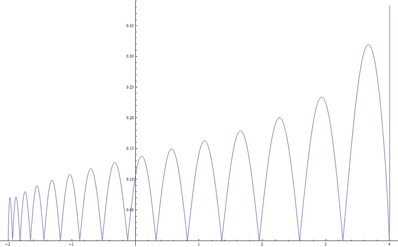

Hi guys and girls of physics forums,
I have just created my account here and so this is my first post and I would like to appologise if my question may have been posted by someone else.
I am new to mathematica but I am very found of the program. So much so that I am trying to use it for one of my research projects as an alternative for mathcad which I've been using for many years and with many frustrations.
I have managed to work my way through functions and what not (I am still learning) but at the moment I've reached a delicate problem. I have this single variable function which has many roots and I would like to know how can I find them all.
I can use FindRoot and get one root at the time given I chose the proper starting value. But is there a vay I can tell mathematica to find the rest of the roots automatically? I am attaching a plot of the function which shows all the positions of the roots for a given set of parameters.
As I said I am quite knew to Mathematica so this question might sound silly but any help would be much appreciated.
Cheers

Use Reduce:
Code:
f = Log[Erf[x/7]] - Cos[x^2 - 1] + 1;
rts = Reduce[f == 0 && 1 < x < 6, x]
myvals = N[x /. {ToRules[rts]}]
I just used an example in Mathematica with a bunch of transcendental roots and then called Reduce to find all the zeros between 1 and 6. Reduce returns a list of logical expressions x= x1 || x=x2 || or x=x3 || and so forth.
The ToRules converts the list of logical expressions to a list of rules x->x1, x->x2, x->x3, and so forth. The N[x/.{ToRules[rts]}] then converts this to a list of numeric values.
Maybe an easier way.
Thank you very much for your reply. This is exactly what I want to do.
My programming experience is in the likes of Matlab and fortran. I am not used to this sort of structure but I a learning by doing.
Again thanks again.
