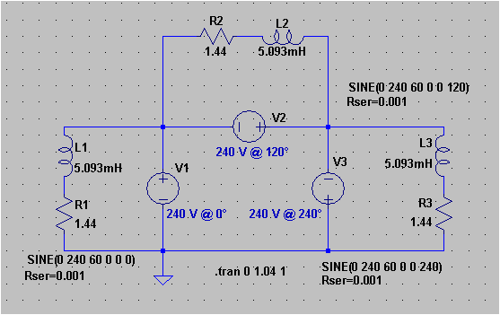

As I said, I'm a bit rusty on multiphase power system measurement/specification conventions. But if we were to assume that the load consists of identical impedances across the phases supplies, and each is drawing 100A with a power factor of 0.6, then we could determine the appropriate impedance (pf corresponds to 53.13° lag angle for the current) and create a Spice model:
[note that the ground is for the convenience of the simulation software]
Each load will draw its 100A, and each phase voltage source will produce 100A, all shifted according to the phase angles of the supplies.
In order to answer the given problem, I would first have to recall or find out: does a single impedance and the power it dissipates characterize the system, or should the power phasors of each load be summed to find total kVA and kW numbers?
