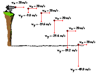

Hello guys,
It is hard for me to explain my question so I'll use a diagram
Consider plane velocity - As centripetal force
Wind velocity- As the velocity of object at the start
R- As the resultant velocity
So in the centripetal force objects this resultant velocity seems constant? How can this be when I add the vectors and use maths as in this question?
Thank you so much :smile:

In order for a force to change an object's direction of motion, but not its speed, that force must be always perpendicular to the object's velocity. That's not the case in your example. As soon as the wind acts, it changes the plane's velocity so that it is no longer perpendicular to the force.

The issue has nothing to do with labels. For the wind to change the plane's direction but not its speed, the wind would have to shift so that it's always hitting the plane sideways to its direction of motion. That's not the case here. This is not an example of centripetal force.
Here's an example that illustrates what you're looking for, I think. Attach a ball on the end of a string and twirl it in a horizontal circle. The horizontal component of the string tension provides the centripetal force. That force is always perpendicular to the ball's velocity, which is tangent to the circle. As the ball moves around in a circle, the force changes direction to stay perpendicular to the ball's velocity vector.
sameeralord said:
In this example if the question says what is the speed of the ball at second circle, I have to add horizonatl and vertical components so how is the speed of the ball constant?
The speed of the ball is not constant. It's falling!
Only the horizontal component of the velocity is constant, since gravity only acts vertically.

The gravitational force is normal to the velocity vector only at the instant the cannonball comes out of the cannon. This is similar to the situation Doc Al described in post #2. Paraphrasing his response, "As soon as gravity acts, it changes the cannonball's velocity so that it is no longer perpendicular to the gravitational force."

Which question? The problem with the cannon ball speed? Sure.

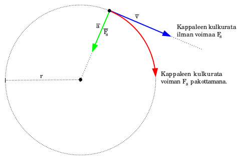

Now this is my misunderstanding. If you look at the second circle in my cannon diagram this is what I'm thinking. The ball velocity is 20m/s and the speed from centripetal force is 9.8 m/s, and the resultant velocity is the vector sum of that? Could you please help using this example.Thank you :smile:
Yes, but there's no 'centripetal force' in this problem, just gravity acting down. Vx = 20 m/s and at the end of 1 second Vy = -9.8 m/s. What's the resultant velocity?

Ok but the resultant velocity is not going to be 20m/s so how is centripetal force changing direction without magnitude? Thanks a lot for helping so far :smile:

I'm considering the blue line as 20 m/s and the green line as 9.8 m/s.

Listen carefully: This is a projectile motion problem. Centripetal force has nothing to do with it! This is not an example of circular motion and centripetal force.
This diagram is not relevant to this problem. There's no circular motion or centripetal force here. It's a projectile motion problem!

I think I just edited my post while you were replying. Could you please help me with the new diagram? Thank you :smile:
See my comments above regarding the new diagram.
