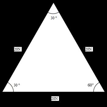

That's an image I have made of the diagram we are given. T1 and T2 are tension 1 and [/i]tension 2[/i] respectively. I need to work out the length of those by:
a). Maths
b). Scale Drawing
I've tried using sine and cosine, but to no avail =\ (although I know we do have to use them to work it out).
Please show me how to work it out, but do not give me the answer!.

First, write out the force equations. This system is in equilibrium, so you need to find:
[tex]F_x = 0 = ?[/tex]
[tex]F_y = 0 = ?[/tex]
Can you see that both tension forces will cancel each other in the x direction? If they are not, then the system is not in equilibrium in the x direction and is in motion, which contradicts the situation. Doing some simple math will tell you that the magnitude of [tex]T_1[/tex] is equal to the magnitude of [tex]T_2[/tex]. Since the angle is the same, the components must be equal in magnitude as well. Since the two tension forces oppose each other in the x direction, they must cancel. We've just proved that the two tension forces cancel twice over!
Can you see what components of each force contribute to the y direction? Obviously the gravitational force vector is simply itself, but what about the tension? How do you find the component that contributes to the y direction? Remember that the magnitude of [tex]T_1[/tex] = magnitude of [tex]T_2[/tex]? Looking at the y components, do they oppose each other (and therefore cancel), or do they complement each other (and therefore are equal)? From these answers you can build your [tex]F_y = 0 = ?[/tex] equation. Solve for the y-component of T.
Once you've found some component of the tension force, you can easily find the magnitude. Suppose you had [tex]T\cos(\theta) = a[/tex], where a is any value. You are given [tex]\theta[/tex]. Can you find T?

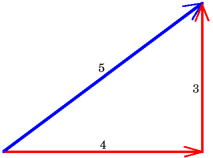

Do you know that [tex]cos(\theta)[/tex] = adjacent / hypotenuse, in a right triangle? If not, now you do. =) Like the other poster said, these trig relationships are key to anything having to do with vectors, which is everything, since vectors are really just motion in non-1-dimensional space, or the entire world.
Consider the first tension force vector. Draw a line from the tip of the vector to the x-axis perpendicular to the axis. Do you see the triangle?
I don't know if you know this so I'll go over it anyways. A triangle can be represented as three vectors. The two non-diagonal sides can be seen as vectors originating from the intersection. I assume you know how to add vectors. What happens if you add these two vectors? You get the hypotenuse vector! What is this hypotenuse vector in your situation? Here's a picture of a vector-based triangle:
Your answer to the above question should've been "tension force". Did you get that? If not, do you see why now?
Do you know the component representation of a vector? It's the x-axis component + the y-axis component. So, by the figure above, we can represent the tension by the horizontal vector and the vertical vector. These horizontal and vertical vectors are the contribution the tension makes in that direction. Now we're getting somewhere - we have a way to find the contribution of the tension along the x-axis! But how do we find it?
Recall that [tex]cos(\theta) = \frac{A}{H}[/tex], or cos = adjacent over hypotenuse. (This is the SohCahToa thing mentioned - I use Some (Sin) Old Hippie (Opposite/Hypo) Caught (Cos) Another Hippie (Adj/Hypo) Tripping (Tan) On Acid (Opp/Adj))
Assume we know the magnitude of the tension. Solve for the adjacent, or the horizontal component, or the contribution the tension makes in the x-direction.
Now, do the triangle thing on the other tension too. You should now have two expressions for the x-component of the tension. You should have the expressions below. If you do not, check your work.

Ok, from what I now know:
http://www.grabup.com/uploads/1800261909D120091B17DB04F125.png
And T1 = T2.
Before I carry on, just want to make sure this is correct. As T1y is equal to T2y, they must each be half of Fg - "10".
perfect, their VERTICAL components are 10N each, you're right, now try to work out the horizontal components or just use sin to work out t1
SO:
sin30 = 10/T2
T2sin30 = 10
T2 = 10/sin30
T2 = 20
Or have I rearranged it incorrectly?
That is correct, to my knowledge.
Thanks, so using maths I have worked out that T1 and T2 are both equal to 20N. So, now I need to tackle part b. Am I right in thinking I'll be drawing the sides of the triangles out as vectors, hoping for them to make a closed polygon?

Everything seems to be in order. Here's how to prove it:
Consider the force triangle formed by [tex]T_y[/tex] and [tex]T[/tex]. The angle opposite [tex]T_y[/tex] is 30 degrees. The angle formed by [tex]T_y[/tex] and [tex]T_x[/tex] is 90 degrees. The angle formed by [tex]T[/tex] and [tex]T_y[/tex] must be [tex]180-30-90=60[/tex] degrees. This force triangle is otherwise known as the 30-60-90 special right triangle.
Theory about the 30-60-90 right triangle states that the angle opposite the 30 degree angle can be considered [tex]x[/tex]. The side opposite the 60 degree angle, then, has been found to be [tex]\sqrt{3}x[/tex]. The angle opposite the 90 degree angle, or the hypotenuse, has been found to be [tex]2x[/tex].
In the case of the tension force triangle, the side opposite the 30 degree angle has been found to be [tex]T_y[/tex]. Thus, [tex]x=10[/tex]. The side opposite the 90 degree angle, or the side in question, is [tex]T[/tex]. Thus, [tex]T=2x=20[/tex]. The final side, or [tex]T_x[/tex], is [tex]10\sqrt{3}[/tex].
You can also see that the vector [tex]T[/tex] can be represented by [tex]<T_x, T_y>[/tex]. The magnitude of T, or the quantity we are interested in, is given by: [tex]\sqrt{T_x^2 + T_y^2} = \sqrt{100 + 300} = \sqrt{400} = 20.[/tex]
Simple physical analysis shows that [tex]T_y = 10[/tex] in terms of magnitude. (You have done this part, so I don't need to prove this.)
This concludes the proof of T = 20. (EDIT: And remember we've proven that [tex]T_1 = T_2[/tex] in terms of magnitude)

I'm not sure about your geometry - could you post a picture? Sorry for the trouble.
http://www.grabup.com/uploads/4200271909D120091B00DB18F155.png
That's a quick sketch. Although now that I think about it, they are vectors so I have obviously added them wrong. Regardless, two of the angles have to be 30 degrees and that alone tells me that not all sides have a length of 10CM / 20N.
From your description earlier, it looks like you're trying to this: draw the force line, then draw the tension lines from it to form a triangle. Is that right? If so, you will not get a correct answer out of this.
Something you could do with this triangle method is to draw both 10N lines continuously, next to a 20N line. This shows that the two y components equal the gravity force. Now draw two lines (representing the tensions) from the ends of the 10N+10N line to form a triangle. Draw a dotted line from the midpoint of the 10N+10N line to where these two new lines meet. See the method here? Here's an attempt at a sketch..
| |3
| |-----------2
| |1
The first line is gravity. The second is the 10+10 line. Imagine a line from 1-2 and 2-3 (those are the tensions). Measure these lines and the angles. You should see what? Notice that the triangle we formed is basically both tension triangles smushed together to form a big one that we can compare with the 20N of the force of gravity.
I didn't understand that completely. Don't worry as I'll re-read it tomorrow morning when I'm fully conscious and see what I can do :P .
I don't know how I managed it but after tweaking the trianlge a bit to make it more accurate I managed to get 20N for each side but this resulted in the interior angles being..well a little bit messed up frankly. Does it matter that they add up to 120°?? At least this way the maths version stays right.
I started by drawing the 20N downwards first (The one given in the first diagram), then measured 30° from each end of the line and finally drew two long lines from each point. If you measure each line from the point at which they join to the original 20N line they should both measure 20N. I hope you get that =/ I can't say that I know it's right though but it sticks to the maths version.
Hmm, I just realized. I haven't added in the horizontal components, it should be an irregular pentagon.
