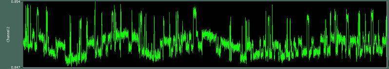

I am using a laser diode to count aerosol particles flowing through a gas stream. The refracted light is being funneled to a photo-multiplier via fiber optics. When there is no gas flowing (and therefore no particles) we are seeing some strange results from the output signal of the photomultiplier. After troubleshooting this problem for more than a year, I am left to believe that there is something going on with the laser diode that I am not able to capture. Is it possible that the light being emitted from the diode is shifting around and causing slight changes in the focal point? What I'm seeing, electrically, is an occasional burst of very small square waves coming from the PMT (photomultiplier). Sometimes it'll last for less than a minute, sometimes it'll last for more than an hour. It starts as occasional spikes (either positive or negative) which get wider and more frequent until the square wave develops and then fades out to more spikes inverse to what it started as. This is my first foray into working with lasers after 20 years with electronics. A more optically experienced hand would be very appreciated.

As far as monitoring the signal, I have done so using both an averaging value (to manage the amount of data) over a 24 hour period, and a high speed method (50ks/sec) observing carefully at the time of the episode. I have monitored current and voltage being output from the laser driver board, power input to the laser driver board, and the PMT bias voltage from the sbRIO-9631. All of them are rock steady and show no correlations to the episodes. This has been a year long process of troubleshooting every electrical possibility and cleaning and shielding and rearranging. Very frustrating. The only thing we have noticed, and keep coming back to, is that the problem gets worse or better (but never fully goes away) when we change the laser diode.
Thank you for your suggestions. I'm going to try a faster sampling rate and examine the frequency spectrum of the PMT output next. See if there's something hiding in what little noise is left on the PMT output that might give some indication as to what is going on.

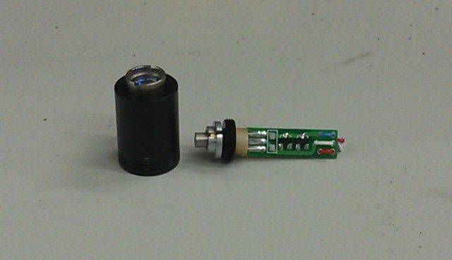

One of the issues we have is that there is no room for anything. The diode is mounted such that there's really no room for anything else near it. There's the diode mounted inside a collimating lens housing, which is mounted in a centering disk which holds the laser centered in a small tube segment which holds the whole sub-assembly in a z-axis adjustment apparatus, which is mounted onto a X/Y axis adjuster thing which mounts onto an X-bracket that mounts onto 4 rods that connect to the “Cage” where the flow-cell is. Mounted in-front of the collimating lens is a 150um orifice and an ND Filter. I don’t even know where to try and thread a thermocouple to take temperature measurements for the LD. I can say that when the LD is mounted, we squeeze it into the collimating housing with an aluminum heat sink collar and a threaded black ring that pushes the diode against the collar and the collar is then pressed against a small shoulder in the housing. In my mind, this should be sufficient for thermal dissipation. I will attach a series of images to show what I’m talking about with the waveform. All of these images are taken with no gas flowing, no particles, and both ends of the sampling tube had been sealed off.

Some more labeling of the axes in the diagrams might be helpful. Are you recording your working signal on the same scale or is this amplified to show the interference more clearly? Time scale is the 50Ks/sec you mentioned?
From the picture the mechanics looks very good to me.

“The "rock steady" output voltage is a bit surprising to me. Uf of a diode is notoriously temperature dependent; I´d expect at least some change in the first minutes of operation until reaching steady temperature.”
When I said “rock steady”, I was referring to monitoring voltage and current supplied to the laser overnight. The driver board does a fantastic job of maintaining the current I set when it’s on, but there is a very small amount of fluctuation during power up. The current tends to be low at first, but as the driver board and the LD warm up (<1min) things level off and become remarkably stable.
“You might want to do your own measurement with some reasonable DVM; maybe you can get at least some idea of temperature changes by monitoring forward voltage.”
I did this with the same DAQ card I used to monitor the output of the PMT and found no correlating changes in current or voltage that would indicate that something on those wires was causing the problem. I time stamped everything and overlaid the charts and found nothing.
