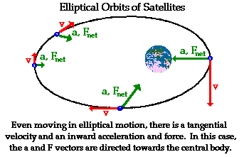

In elliptical motion - the velocity and acceleration will have radial and tangential components that vary. The result is that the velocity and acceleration vectors rarely point perpendicularly to the radius vector:
Notice that the net force points opposite to the radial direction all the time but there are only two places where the velocity vector is perpendicular to that.

I re-read your diagram. Does this mean that r and v are not necessarily perpendicular, but r and a are parallel even in an ellipse?

Yes.
The acceleration always points in the direction of the net force.
In orbits, like shown in the vid, the only force is gravity ... and that will always point at the central mass - so the acceleration always points that way too.
The velocity vector, however, always points in the (instantaneous) direction of travel ... that is part of the definition of "velocity".
Since an object in orbit is constantly changing direction, the angle between velocity and acceleration will vary - except for a circular orbit.
Yes. Provided the only force on the object orbiting comes from the thing it is orbiting.
