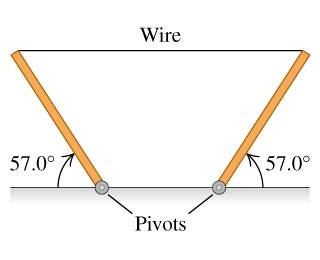

5.10m, 0.733kg wire is used to support two uniform 230N posts of equal length. Assume that the wire is essentially horizontal and that the speed of sound is 344m/s. A strong wind is blowing, causing the wire to vibrate in its 7th overtone.
What is the frequency of the sound this wire produces?
fn=nv/2L
v=sqrt(F/linearmass)
sumF=0
-split the force vectors into their components
-multiplied the force along the x-axis from one of the posts by two to find the tension in the string
-used this value to find velocity
-used velocity to find the frequency of the 7th overtone
-got answer wrong
help?

230cos(57)=125.3
125.3X2=250.5
Tension is not balancing forces. Its their torques which are balancing.

This isn't correct. The 230N isn't the tension/compression in the post... it is just the weight of the post. As Sourabh N said, use torque about one of the pivots (either one doesn't matter which one)... net torque about the pivot is 0.

The 230N force is acting at the center of the post (midpoint)... The tension is acting at the end of the post...

Torque is r X F. This can be interpreted as force times the perpendicular distance from the line of force to the pivot... ie the torque due to the weight is 230N*(L/2)cos57... if we take clockwise positive and counterclockwise negative and look at the left pivot... torque due to the weight is -230*(L/2)cos57
What is the torque due to tension about the left pivot? The force is T. What is the perpendicular distance from the line of force to the pivot?
The sum of these 2 torques is 0.
the torque on the right pivot is 115(L)cos57
the torque on the left pivot is -115(L)cos57
so if I use torque=Fd
and the torque is the above calculated values...and the force is the tension in the wire and d=(L)sin57
then F(right pivot)= (115(L)cos57)/(sin57(L))
F=74.68N
so the total tension is 74.68X2=149.36N
the use this value for the tension in the string
is that correct?
You don't need to multiply by 2. The tension is just 74.68N.
T=74.68N
v=sqrt(74.68/(0.733/5.1))
v=22.79m/s
f=6(v/2L)
f=13.4Hz
what is wrong with those calculations?
the answer is still wrong
I think you should be multiplying by 8 not 6.
