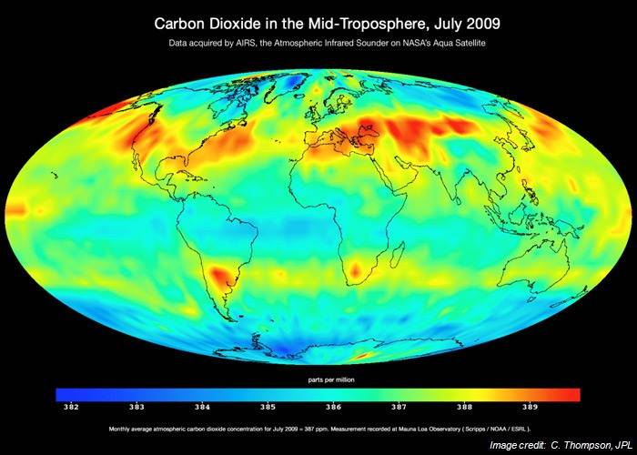

So what is the color scale and the range of the variation?
Of CO2 variation described in the first link? There was a press release about this just recently: http://www.jpl.nasa.gov/news/news.cfm?release=2009-196&icid=%27MostViewHome%27 (JPL press release, December 15, 2009).
Some key features. CO2 is not uniformly distributed, but "lumpy". In particular there is a band of higher concentrations of CO2 in the Southern Hemisphere not previously seen. Here's a diagram, showing the scale.
(Credit: C. Thompson/JPL/NASA)

Looks like large emissions over the US and Europe are being swept towards towards the southeast by prevailing winds. Large concentration is pooling over Kazakhstan.
China emission are being swept more towards the northeast and pool off the coast of Canada. Argentina/Brazil and South Africa emission area also observable.
Australia, while high on per capita emissions basis looks to have small over all emissions.
Sink over Sibera makes sense because of all the tree, but can think of no reason for sink over Greenland.
Also looks like Maun Lau is in a slightly above average location while the Congo and Amazon are in the middle of a below average sink. There is a oddly high concentration along the equator in the middle of the Pacific Ocean.
