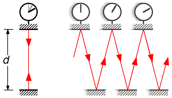

OK, how do you explain the WIKI article.
Would you please use the experiment in the article to prove reciprocal time dilation?
  • #74
chinglu1998 said:
Tes, I start to think WIKI is correct. The absolute light abberation causes a longer path for the light travel for the primed framer vs the unprimed frame in an absolute sense.
Let me take the unprimed frame as stationary. This promed frame light beam still longer.
c²t'² = v²t'² + c²t²
c²t'² - v²t'² = c²t²
t'²( c² - v²) = c²t²
t' = tγ
Wow, when taking the unprimed frame as stationary with absolute light abberation, the moving clock beats faster just like WIKI said.
No, any clock in the moving (primed) frame must be running slow as measured in the stationary (unprimed) frame. I showed why this is not incompatible with the wiki's time dilation equation in post #62.
You have to define the precise meanings of t and t' in your equations. t' doesn't deal with any single "moving clock", rather it is the time in the primed frame between the event of the light being emitted from the bottom of the light clock (which is at rest in the unprimed frame and therefore moving relative to the primed frame) and the event of it hitting the top of the light clock (this event will occur at a different position in the primed frame). To measure the time of these two events in the primed frame using clocks, you would need a pair of clocks at different positions in the primed frame. As I explained in #62, each of these primed clocks is individually running slow as measured in the unprimed frame, but the unprimed frame nevertheless agrees that t' is greater than t because of the way the two primed clocks are out-of-sync in the unprimed frame.

  • #77
JesseM said:
There is no single "moving clock". 25s is the time measured in the primed ('moving') frame between two events on the worldline of the clock at rest in the unprimed ('stationary') frame. But these events occur at two different positions in the primed frame, so you'd need a pair of clocks at rest and synchronized in the primed frame to assign time-coordinates to both events in a local way, after which you could figure out their difference in time-coordinates. That's how position and time coordinates are supposed to be assigned in SR, using a lattice of rulers and clocks at rest relative to one another and synchronized using the Einstein synchronization convention, as illustrated here:
Einstein also discusses the idea that coordinate times and coordinate positions should be defined using local measurements on a set of rulers and synchronized clocks in sections 1 and 2 of the 1905 paper you linked to.
As always, "moving" and "stationary" are arbitrary labels. Changing the labels does not magically change any facts about the amount of coordinate time between two specific events in different frames. Instead of playing these silly word-games, why don't you go through my analysis using the Lorentz transformation and figure out specifically where you think I made an error? Do you disagree that if a clock is at rest at x=0 in the unprimed frame, then the coordinates of it showing a time of 0 would be x=0,t=0 while the coordinates of it showing a time of 20 would be x=0,t=20? Do you disagree that when we transform x=0,t=0 into the primed frame we get t'=0, and when we transform x=0,t=20 into the primed frame we get t'=25? Please address these quantitative specifics instead of retreating into vague word-games.
Your conclusions are correct. Do you understand them?

  • #86
The upper picture is of the light clock in its rest frame and is used to define the time interval between ticks of the clock in its rest frame. The second picture is of the same light clock in a frame in which it is moving and is used to derive the time interval between ticks in that frame. Since the velocity of the light clock is perpendicular to that of the path the light takes in the light clock, this path length is invariant (under the transformation from the unprimed frame to the primed frame). Then follow a few lines of algebra culminating in a relation between the interval between ticks in the primed and unprimed frames (this algebra only assumes that space is euclidean, the velocity is perpendicular to the light path, and that the primed position is the time-integral of the primed velocity, all of which are valid in SR). If one measures the number of ticks (N) of the unprimed clock in the primed frame during a time period [tex]$\alpha{}$[/tex] as measured by N' ticks of an equivalent clock in the primed frame, [tex]$\Delta{}t'=\gamma{}\Delta{}t\Rightarrow{}\frac{\alpha}{\Delta{}t'}=\frac{\alpha{}}{\gamma{}\Delta{}t}\Rightarrow{}N=\frac{\alpha}{\gamma{}\Delta{}t}\,\,\,\,N'=\frac{\alpha}{\Delta{}t}\Rightarrow{}N=\frac{N'}{\gamma}$[/tex]
Thus, the unprimed clock ticks fewer times than an equivalent clock at rest in the primed frame for an arbitrary time period measured in the primed frame. So, a clock that ticks once per second in its rest frame would be measured to tick 4 times when traveling at 0.6c relative to a frame in which an equivalent clock at rest would tick 5 times.
Fine, let us assume the WIKI experiment.
Let us further assume the unprimed frame has the light source like WIKI .
Now, let's conduct the experiment from the view of the unprimed frame.
It's view is the light will satisfy t = y/c for some y on the axis.
Now, in the primed frame, it will see light aberration, hence the light path is longer in the view of the primed frame.
Apply the Pythagorean Theorem and you calculate t' = t γ just as WIKI said, but this is not time dilation since the unprimed frame is at rest.
Now assume the primed frame is at rest. Same thing, light aberration will force that frame to conclude t' = t γ.
So, it does not matter which frame is stationary, t' = t γ.
  • #96
Everyone in this thread is making the same error.
Apply light aberration when the primed frame is stationary or the unprimed frame is, it does not matter.
It will always be the case if the light source is at rest with the unprimed frame, t' = t γ
  • #97
