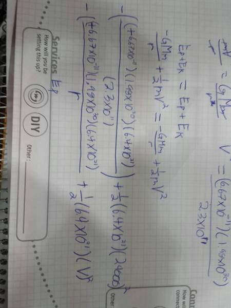

Do you know the escape speed for Mars orbit as regards escaping from the Sun's gravity, or know how to get it?
I can do it on a projectile that is leaving a planet, not sure how I'd do it on two planets.
The EP and Ek in the 2nd are 0, right?
How about from one planet with the mass of the Sun and radius equal to Mars's orbit?
Not sure I quite follow that. Are my other calculations not correct?
I did math in the above and got escape velocity of 33888 m/s.
Also, the escape velocity to hit something from the surface of Mars so that it does not come down is 2.4 km/s. If that helps at all.
The 338888 m/s is what I was asking. (Actually, using the figures given in the problem, I got 33941 m/s.)
For an object that is at a distance of 2.3 * 1010 m from the Sun, 338888 m/s is the escape velocity for escaping the Sun. I.e. 338888 m/s is the velocity that Mars needs to escape the Sun's gravity.
And so by that, if it is only traveling at 30000 m/s, it will in fact not escape the Suns gravitational field, and thus remain in the solar system?
Correct.
There are other ways to show it.
They agree.
