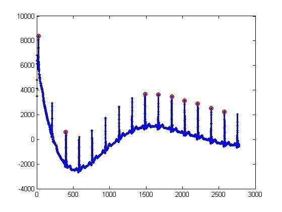

Hi, I'm also facing same problem, I'm doing a heart signal peak detection project and i attached the plot result , can u tell me how i solve this ?
Thanks
Thanks
Given the above example: x = [1 1 1 1 3 4 1 1 1 1]
peakfinder (http://www.mathworks.com/matlabcentral/fileexchange/25500) gives you the following:
[peak loc] = findpeaks(x)
peak = 4 <-- the amplitude of the peak is 4
loc = 6 <-- the location of the peak is 6
there are also lots of other useful functions included in the package.

Can tell me how to proceed this code? I'm really new for this ,thanks
Setting up peakfinder
1. download the peakfinder package from the link above. extract/unzip the folder and put it in a folder under your MATLAB path
2. in matlab, add the peakfinder folder to path (file -> set path, click on set path, select the peakfinder folder by browsing, click on save, then click on close)
Using peak finder
assuming your signal is already in the MATLAB workspace called x, to find the peaks using peakfinder, type in the following in the MATLAB command window:
[peaks, locs] = findpeaks(x)
this would result in two vectors:
peaks = [# # # # # ... ] <-- indicates all the peaks that are found in x
locs = [# # # # # ...] <-- indicates all the locations/positions of the found peaks
to examine the peaks found using this setting, you can type in the following:
plot(x);
hold on;
plot(locs,peaks,'o','MarkerEdgeColor','r')
more functions/setting can be consulted through typing 'help peakfinder' in the MATLAB command window. hope this helps.

I'm not sure if i should leave this message here,but I'm doing it, here's my problem,like u said i tried with the code ,it was very nice and very useful,it doing well when i input the data under 1200sampling frequency,but when i tried other data under different sampling frequency the result was not satisfactory, here i attached something related to my issue
